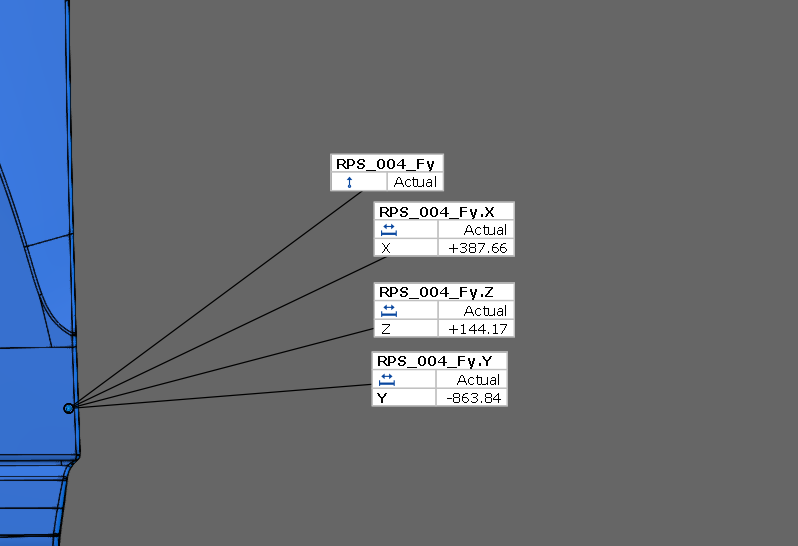

Hello,
For a specific point I wanted to show the actual values only. But I am getting individual X, Y, Z labels, how can I merge them together? & this is happening to some labels only.

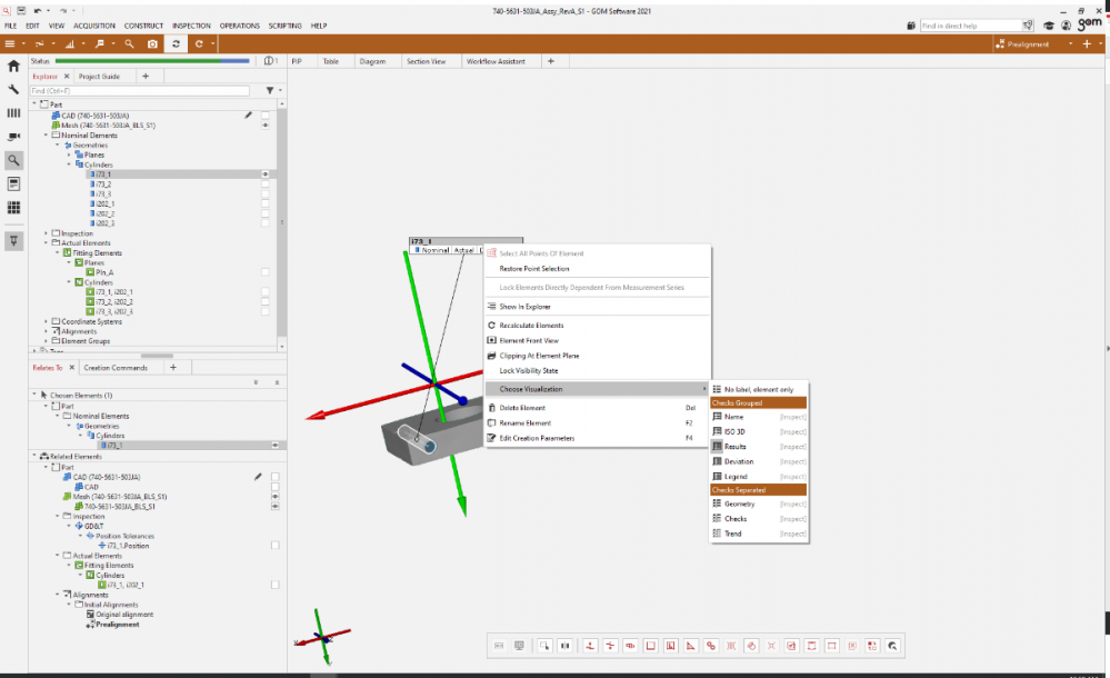

On the 3D viewer right click on the label then go down to "choose visualization" then select what you need.
Play with the settings till you get it right (takes a little while to understand it).
