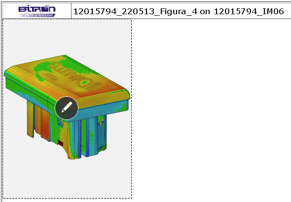

Hi,

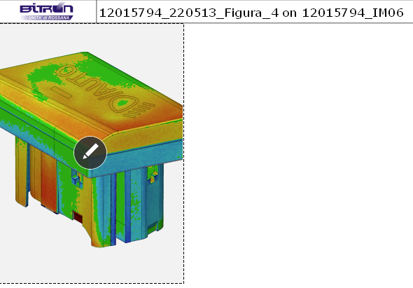

I have a problem with the script recorder to take the image of a 3D comparison. I want to take the image of whole part, and when I record using the function "Reset Zoom" it succeed, but when I run the script it doesn't work. The first is the image taken when I record the script, the second one is the image taken running the script. The part is cut. And this is the code I used. Why it doesn't work? I am wrong with something? Thank you very much.
# -*- coding: utf-8 -*-
import gom
gom.script.cad.show_element_exclusively (elements=gom.ElementSelection ({'category': ['key', 'elements', 'part', gom.app.project.parts['Part'], 'explorer_category', 'inspection', 'object_family', 'surface_comparison', 'type', 'surface_comparison']}))
gom.script.view.adapt_zoom (use_animation=False)
gom.script.report.create_report_page (
	animated_page=False,
	animation=['snapshot_frame_6', 'Animation by all stages, 12.0s (2)'],
	imitate_fit_mode='overwrite',
	template_name='Report_Bitron_A4_Horizontal_Stage_Vecchio_Nuovo_a4',
	template_orientation='landscape',
	template_package={'name': 'Bitron', 'uuid': '11a448bd-b5a9-4f56-acfe-5d55966554dc', 'version': '1.0.79'},
	title='$format (page_number, "", show_unit=false, date_format=\'dd/MM/yyyy\')$ - $format (number_of_pages, "", show_unit=false, date_format=\'dd/MM/yyyy\')$')
Hi,
I had this exact problem before and to me it seemed to be because of the screen resolution. I don't like it, but try switching to 1920x1200 and see if it helps you.
Hi! Thank you very much, but my monitor isn't able to use this resolution. I'll try to do some tests with resolution. Thank you!
