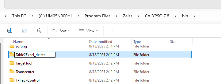

[St...] Posted September 4, 2025 Share Posted September 4, 2025 Hi Jeff, Reviving the discussion because we are having mysterious delays at end of CNC run, endless 'table file will be generated' messages, with some measurement plans. In the help files the function of 'Export Points' you mention seems to be described under 'Basics of the automatic subsequent evaluation'. If fully implemented it sounds like it would save time, but I suspect many users are not pursuing this to the end. So it seems having 'Export points' checked produces activity that serves no immediate purpose, right? We do make extensive use of 'Save measured points' for re-evaluations and I understand its function, but can I safely disable 'Export points'? Is there any other reason why our report takes so long to appear at the end of the CNC run? Thank you, 1 Link to comment Share on other sites More sharing options...

[An...] Posted September 6, 2025 Share Posted September 6, 2025 No problem, Please sign in to view this username. . Other possible causes are running PiWeb via Windows administrator privileges (which should not be activated), as well as saving to a network drive (which can work but is also often known to be glitchy). Link to comment Share on other sites More sharing options...
[Ch...] Posted September 9, 2025 Share Posted September 9, 2025 Please sign in to view this quote. A process that is new to CALYPSO 7.8 and 8.0 that can cause "Table File" delays at the end of runs is CALYPSO's automatic output to excel via C:\Program Files\Zeiss\CALYPSO X.X\bin\Table2Excel. This tool is designed to take any Table File present and create an excel file however if you don't care to use this resulting excel file it can often lead to unwanted delays. Try deleting or renaming the folder C:\Program Files\Zeiss\CALYPSO X.X\bin\Table2Excel and see if that speeds things up at the end of runs. 2 Link to comment Share on other sites More sharing options...
