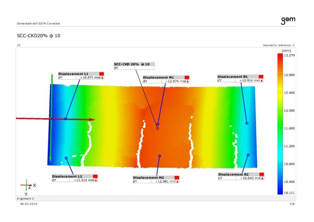

[Mu...] Posted June 6, 2022 Share Posted June 6, 2022 (edited) Hello there I am using 2D-Correlate now. I have a crack pattern for a concrete surface. Are there any methods to compute crack area (width and length) covered in specific pixels as a fractional of the total area, by using Fractal Dimension theory? Edited June 6, 2022 Link to comment Share on other sites More sharing options...
[Th...] Posted September 26, 2022 Share Posted September 26, 2022 Hi Musab, we do not use this by standard. But in scripting (available for correlate pro) you have access to all data created by correlate and also all powerfull pyhton packages (numpy, scipy, ..., "whatever"py) - maybe you are able to create your desired data with this. Hope this helps. Best, Thorsten Link to comment Share on other sites More sharing options...

[Ma...] Posted January 18, 2023 Share Posted January 18, 2023 Hi Musab. There is no built-in functions for fractal. But as Thorsten mentioned only answer in GOM Correlate is python. This open the door for anything you need You have possibility to use full version for 14 days. and import inside a python enviroment FractalDimension and later use together with Please sign in to view this quote. Marcin. Link to comment Share on other sites More sharing options...
