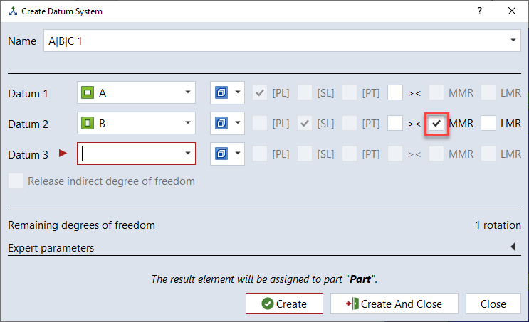

[Ar...] Posted June 29, 2022 Share Posted June 29, 2022 How to inspect the part with datum modifier example PROFILE TOLERANCE 0.0900 TO DATUM A | BⓂ | CⓂ. Do we have option in GOM 2021 to call for Datum Modifier Link to comment https://qualityforum.zeiss.com/topic/1100-datum-modifier-maximum-material-boundary-mmb-check/ Share on other sites More sharing options...
[Di...] Posted June 29, 2022 Share Posted June 29, 2022 Hi Arun, you first have to check the elements either with independency principle, envelope principle or linear size because the size is needed for the computation. You will find those checks in I-Inspect -> GD&T Quick Creation. Afterwards you can simply enable the usage of MMR inside of the create datum system dialog Hope this helps. Best regards Dinko Link to comment https://qualityforum.zeiss.com/topic/1100-datum-modifier-maximum-material-boundary-mmb-check/#findComment-3566 Share on other sites More sharing options...
