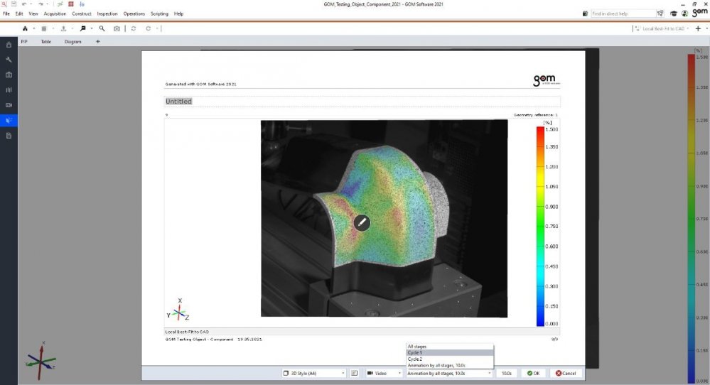

[La...] Posted July 5, 2022 Share Posted July 5, 2022 I've created a report with elements I'd like visible only during one stage range. As the video plays, I want ValueElement_1.DIM to display during Test_1 stage range, followed by ValueElement_2.DIM displayed during Test_2. The video spans all stages. These are imported external datafiles that accompany 2 test sequences in my Aramis project file. The resulting video is not applying the visibility restrictions I set for ValueElement_1 and ValueElement_2 (though the restrictions appear to apply correctly when I'm editing the report field of view and paging back and forth through stages). It is keeping visibility of whatever stage I was in when clicking OK. Am I misunderstanding this restriciton property, or is this a bug? Link to comment Share on other sites More sharing options...
[Iv...] Posted July 15, 2022 Share Posted July 15, 2022 Hello Lauren, you have to change the stange range you would like to show in the video in the following dialog (see the attachment) during the creation dialog. You can change it also afterwards. Hope this helps, Ivan Link to comment Share on other sites More sharing options...
[La...] Posted August 8, 2022 Author Share Posted August 8, 2022 Hi Ivan, Thanks for the response. I'm trying to do something slightly different, though. I want the report video to play All Stages (Test1 then Test2 in one report). When It's playing Test1, ValueElements2 should be hidden, and vice versa for Test2/ValueElements1. Lauren Link to comment Share on other sites More sharing options...
[Iv...] Posted August 23, 2022 Share Posted August 23, 2022 Hi Lauren, this option is not available in the reporting area. I would recommend to export both of the videos and combine them afterwards. Greetings, Ivan Link to comment Share on other sites More sharing options...
