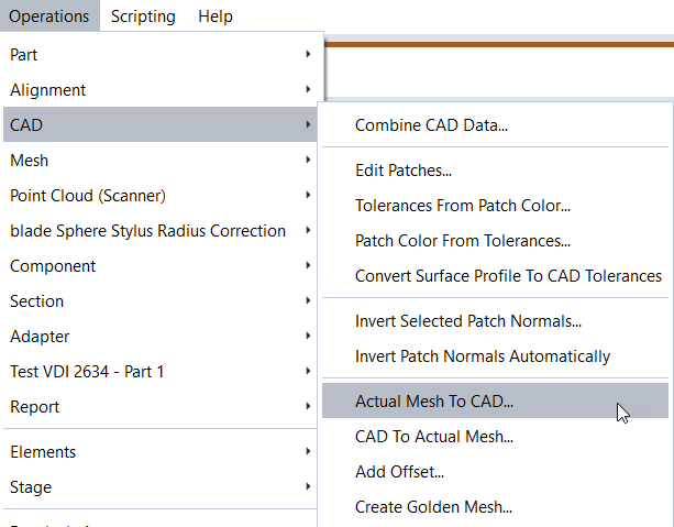

[Ju...] Posted July 6, 2022 Share Posted July 6, 2022 Hi, GOM Inspect is really strong at generating surface comparison and export them in ASCII. I wonder if you have an easy trick to reverse the surface deviation compared to the CAD ? I mean getting color inverted on the surface comparison with this reversed surface compared to the initial one, with the same CAD file (and not just by changing color of the scale bar 😉) So how to get positive displacements turned into negative ones and vice versa ? Thank you ! 🙂 Link to comment Share on other sites More sharing options...
[Ju...] Posted July 6, 2022 Share Posted July 6, 2022 (edited) Hi, Maybe you can try turning your mesh into a CAD and your CAD into a mesh. Quick and dirty trick but should give you what you want. Edited July 6, 2022 Link to comment Share on other sites More sharing options...
