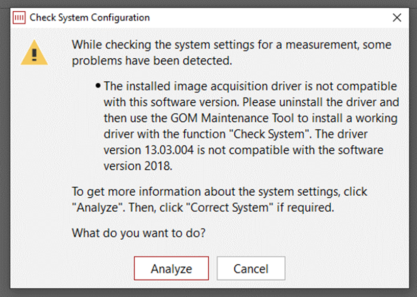

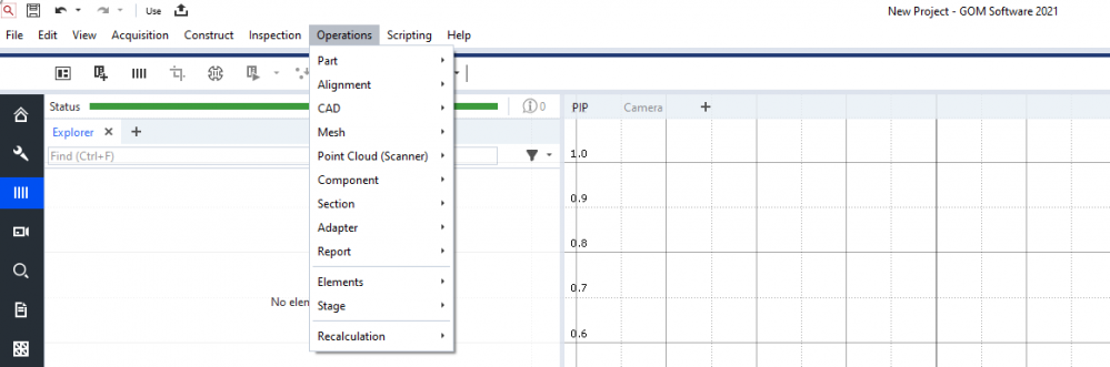

As the VDI 2634 testing a default menu with GOM ATOS 2018.after upgrade to ATOS Software 2021, it's disappeared, and the V2018 is no longer available.
then how i can perform the VDI test with newer version.

With regards to the VDI scripts they have to be downloaded from the software Packages area.   The driver error is something else..you should uninstall the Commonvisionblox software and re-install through the maintenance tool as the dialogue suggests.
Thanks for your answer .I have downloaded software package and it works well. 🙂
