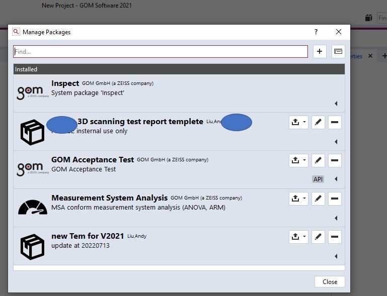

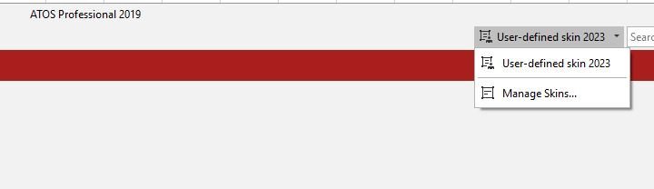

[li...] Posted July 18, 2022 Share Posted July 18, 2022 As I have define some key words / report template and save these as package. but when i try to create a new project. all these setting is no longer available. then how i can set the user-defined skin (package) as the default skin with ATOS V2021. Thanks! Link to comment https://qualityforum.zeiss.com/topic/1167-how-i-can-set-user-defined-skin-package-as-the-default-skin/ Share on other sites More sharing options...

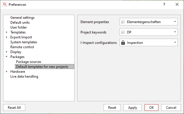

[Na...] Posted July 18, 2022 Share Posted July 18, 2022 Hello Andy, packages are either installed or not in the 2021 and you have access to the included templates all the time. You can define standard templates in the preferences -> packages for new projects. Regards, Nanno Link to comment https://qualityforum.zeiss.com/topic/1167-how-i-can-set-user-defined-skin-package-as-the-default-skin/#findComment-3805 Share on other sites More sharing options...
[li...] Posted July 20, 2022 Author Share Posted July 20, 2022 Please sign in to view this quote. Thanks for your answer. Yes, the default key words now is available when i create a new project. How about the report template? I have to re-link all the key words after i create a new report template? Is there a way to combine all these setting (UI.key words,report template...) to be a skin or package. just like V2019.... Link to comment https://qualityforum.zeiss.com/topic/1167-how-i-can-set-user-defined-skin-package-as-the-default-skin/#findComment-3833 Share on other sites More sharing options...
[Na...] Posted July 20, 2022 Share Posted July 20, 2022 Hi, the report templates are available in the report work space as soon as the package ist activated. The correct keyword set has to be defined according to the keywords on the report page template. Link to comment https://qualityforum.zeiss.com/topic/1167-how-i-can-set-user-defined-skin-package-as-the-default-skin/#findComment-3839 Share on other sites More sharing options...
[Ti...] Posted August 22, 2022 Share Posted August 22, 2022 Hello, We have a package that has a report header saved and everytime a new programmer opens up a project that template is there for use. I need to make a small change to the report header. How can I save this to the package or create a new one. I've poked around, but I don't see how to do this. Thanks. Link to comment https://qualityforum.zeiss.com/topic/1167-how-i-can-set-user-defined-skin-package-as-the-default-skin/#findComment-4190 Share on other sites More sharing options...
[Na...] Posted August 24, 2022 Share Posted August 24, 2022 Hello Tim, you have to make the report style editable with a right click, change the header and then click on manage templates in the tab "Report templates". Then add it to a package in this dialog. Link to comment https://qualityforum.zeiss.com/topic/1167-how-i-can-set-user-defined-skin-package-as-the-default-skin/#findComment-4228 Share on other sites More sharing options...
