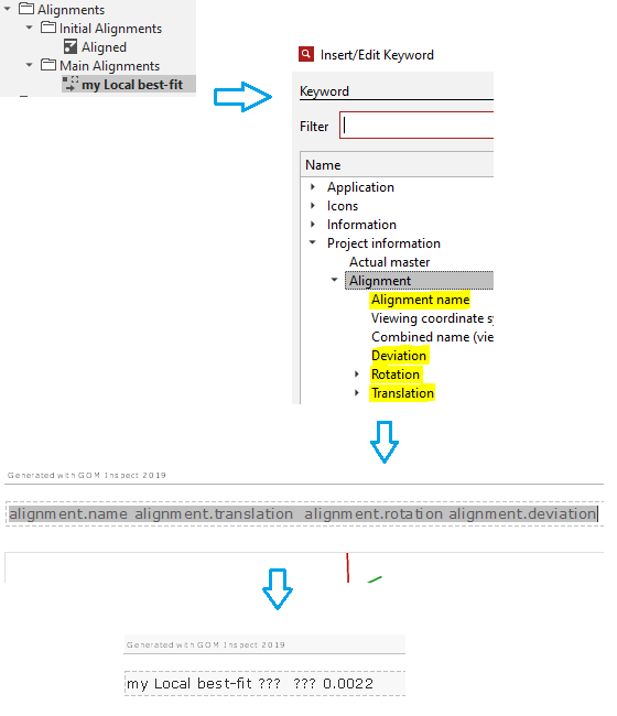

[Ad...] Posted March 3, 2021 Share Posted March 3, 2021 Dear GOM Experts I need to get the transformation matrix of best fit alignment. I have found hint here https://support.gom.com/display/KNOWLEDGE/Transformation+Matrix but not all information can be displayed. Picture below shows the details, why do i have question marks "???" instead of values ? Best Regards Adam Link to comment Share on other sites More sharing options...
[Be...] Posted March 3, 2021 Share Posted March 3, 2021 Hi Adam, translation and rotation are no simple scalar values and therefore you have to specify which member (x, y or z) you like to display. If you want to specify all of them, you have to insert the token with the appropriate member three times. Hope this helps?! Regards, Bernd Link to comment Share on other sites More sharing options...
[Ad...] Posted March 4, 2021 Author Share Posted March 4, 2021 Yes, thanks. It is clear. Regards Adam Link to comment Share on other sites More sharing options...
