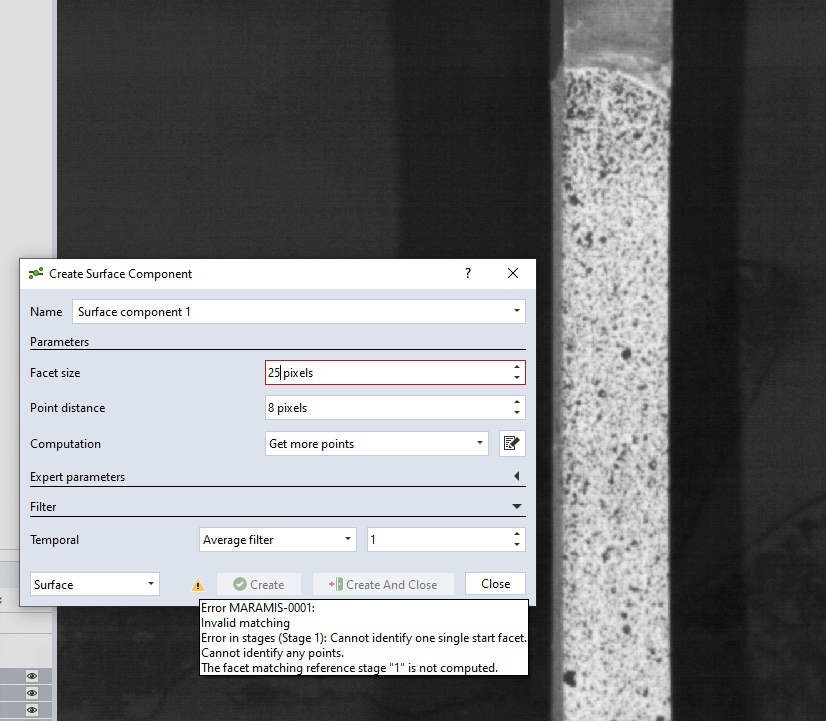

[Zo...] Posted July 26, 2022 Share Posted July 26, 2022 Hi, I'm using Aramis 12M and Corelate cannot identify any facet on the initial/referent stage (I tried with all settings, sizes, filters...). I also recalibrated sensor. Any help is welcomed, Best regards. Link to comment Share on other sites More sharing options...
[Iv...] Posted August 23, 2022 Share Posted August 23, 2022 Hi Zoran, your image seems a little bit blurry. But to receive a better reason for a not finding of your facet you can do following: Try to create a single facet point. You find this option in the same spot like the surface component creation. Hold CTRL/STRG and go over the surface. You receive a label with some information and at the bottom a reason for not finding/creating a facet. Afterwards you can use this information to solve the problem. Check also the image of the right camera. Greetings, Ivan Link to comment Share on other sites More sharing options...
[Th...] Posted September 26, 2022 Share Posted September 26, 2022 Hi Zoran, you can also use a facet point component as start facets. Create a facet point component (clicking a few facet points along your specimen - if this doesnt work Ivans comment applies). Then create a surface component with this component as startfacets (Create Surface Component - Expert parameters: Start facets = "Facet Point COmponent"). As it looks your specimen seems to fill only a very small part of your image - this can lead to trouble with automated startpoints. Anyways, it could be a good idea to use a little smaller measurement volume to get a better resolutionand more of your specimen filling the image. 😉 Best, Thorsten Link to comment Share on other sites More sharing options...
[Ti...] Posted October 4, 2022 Share Posted October 4, 2022 To add to Thorsten's suggestion about the image size, for tensile tests we like to rotate the camera bar so that it is parallel to the specimen. We can then crop the image height and still fit the entire specimen in the image. This has benefits for more than just the start facets, too, since it will allow you to record at a higher frame rate and reduce overall file size. It can be a little complicated if the grips holding the specimen are large, but overall I much prefer this setup for tensile tests. Link to comment Share on other sites More sharing options...

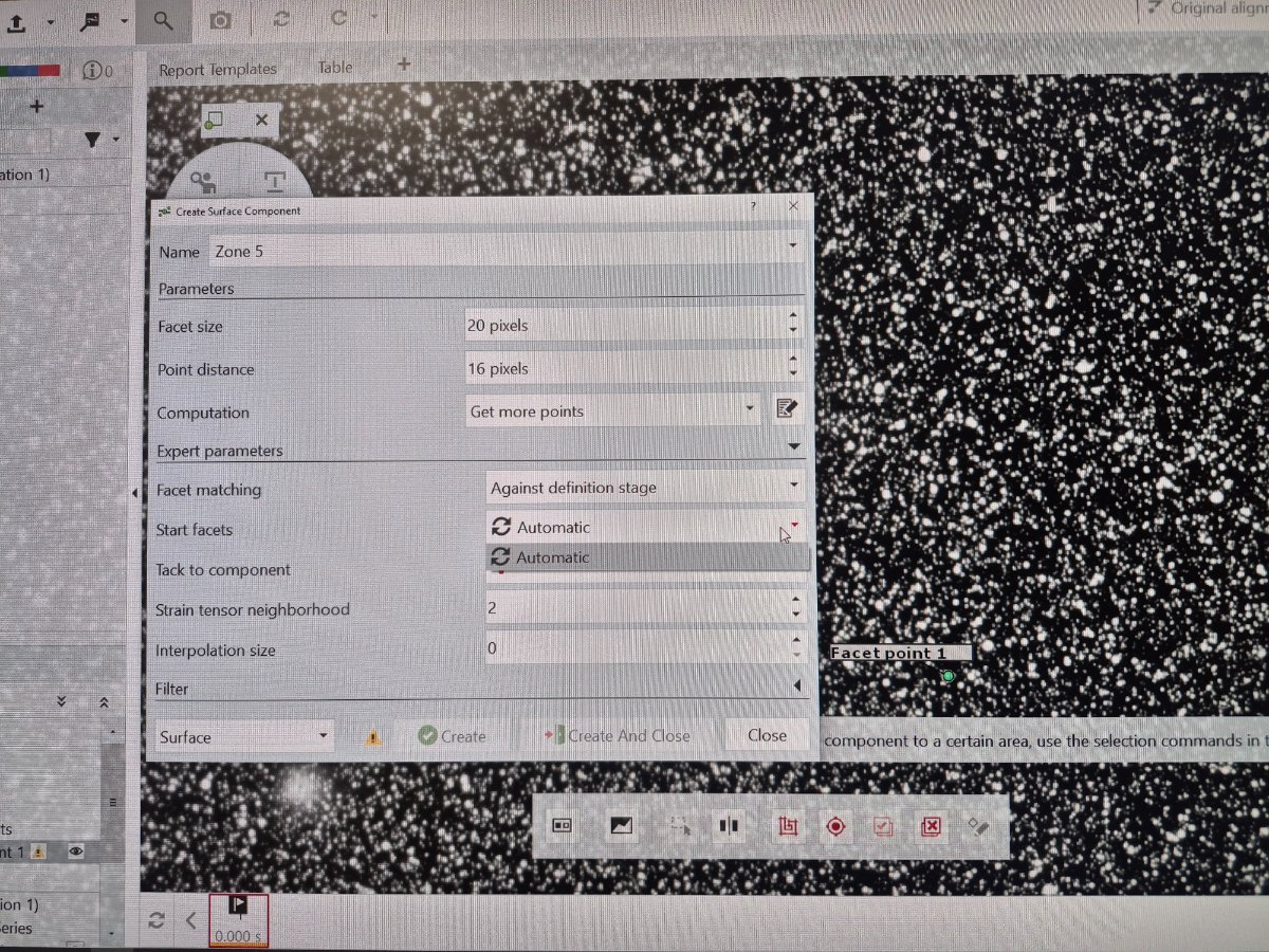

[So...] Posted October 15, 2025 Share Posted October 15, 2025 Hii I also faced same problem, and when I tried to create a facet point manually, and then creating a surface, in the start facet only "automatic" option is there. How to change it? Link to comment Share on other sites More sharing options...
[Th...] Posted November 25, 2025 Share Posted November 25, 2025 Hi Soumya, you need to use/ create a facet point component (and not just a single facet point). This can then be used as startpoints. If you want to, the component can also consist of only one single point. Link to comment Share on other sites More sharing options...

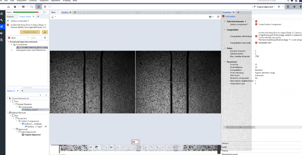

[So...] Posted December 11, 2025 Share Posted December 11, 2025 Please sign in to view this quote. Hii Thanks for the comment. I tried that, It worked. But again is gives another error message saying "invalid matching". Cannot compute neighbouring facets for the given start facet. And the referrence stage 1 in not computed. Any idea what to do? Link to comment Share on other sites More sharing options...
