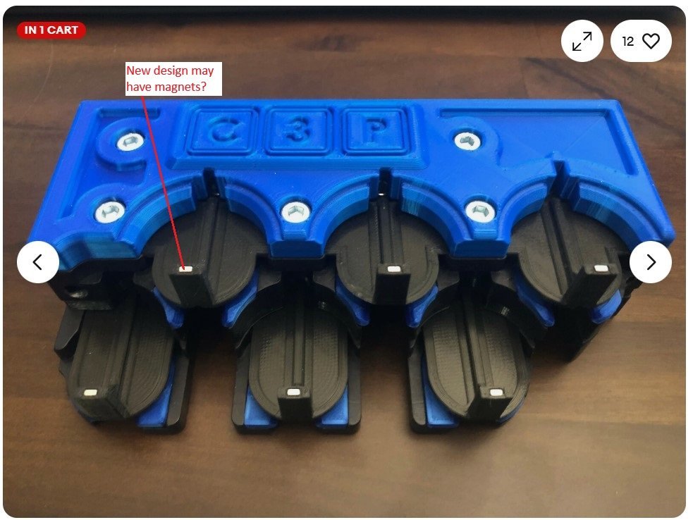

[Ri...] Posted July 24, 2025 Share Posted July 24, 2025 I know of a business using many of these, a lot of them. They had one single issue that was easily resolved. The Lid that covers the stylus, the springs can come unattached preventing the lid to close. Thier fix, they glued a small magnet to the back of the lid, a magnet strong enough to stay in contact with the XXT sensor after it extracted the stylus, which closes the lid to cover either the stylus or empty socket. Link to comment Share on other sites More sharing options...

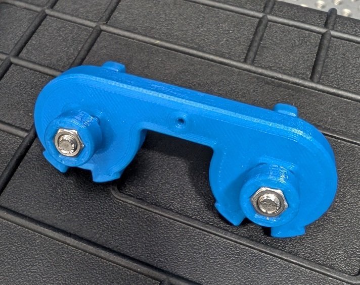

[Th...] Posted July 24, 2025 Share Posted July 24, 2025 I have one of these. Yes, the covers now have small magnets press-fit or glued into the vertical tabs so the XXT will pull it shut. There's no constant force keeping them extended, so if you open one up it stays open until you or the XXT catches it and moves it back. Locating the rack tiers is done with an insert they pack in with the rack. Didn't realize I took a picture of the underside, but you can see the thumb turns poking out along the top and the hole where the countersink is for the XXT to locate in. Link to comment Share on other sites More sharing options...
