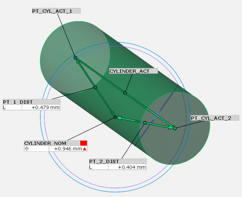

Below is view 1 of this scenario. I expected calculated value shown under "CYLINDER_NOM" label shall be == PT_1_DIST * 2
(0.479*2 = 0.958)
but calculated value is 0.946
PT_1_DIST is a longest distance between fitting cylinder axis and nominal cylinder axis.

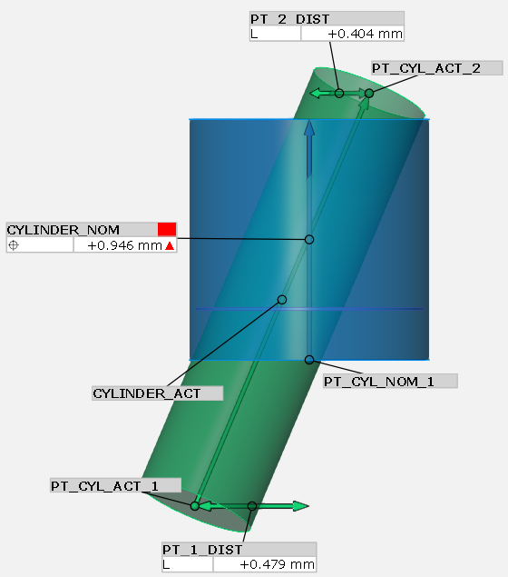

below is another view of the same scenario :
From my point of view , expected value is 0.958

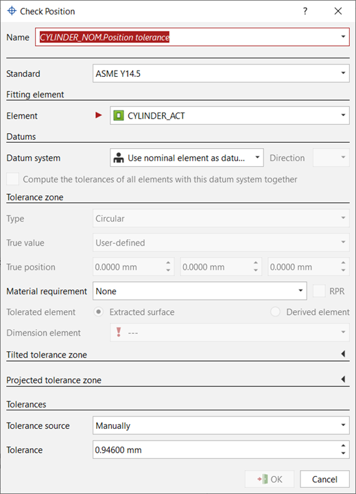

This is how Position tolerance was set :
I am obligated to use ASME standard. I put tolerance value == 0.946 mm to have visualisation of area of tolerance only.

In GOM documentation, i found for ASME standard GOM will use "maximum inscribed element" for fitting cylinder.

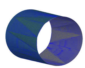

1) First the tesselation of your artificial cylinder is too rough. GOM Software takes his computation on points only. Therefore a descent number of points is needed. Therefore please refine your mesh until you get something like this:
Afterwards the maximum inscribed cylinder should delivers the correct result.
2) And according to ASME Y14.5 for a position tolerance RFS you have to build the axis of envelope element in your case a maximum inscribed cylinder. Afterwards you check if the whole axis is inside the tolerance zone that position is restricted from the used datum system. That means yes, GOM is using the maximum inscribed cylinder because the standard demands it (at least for this case and for the ASME evaluation).
Of course if you have a ISO position tolerance we extract the "middle-point-axis" according to the ISO standards
3) Geometry ignores the requirements of the standards are using the axis of the cylinder. Due to the fact that there is a difference between Best-Fit-Cylinder as in your project and maximum inscribed cylinder, there is also a difference in result. Please have a look into the warning into at tech guide/online-help that state that you may get non-standard conform evaluation if you are using the geometry mode.
