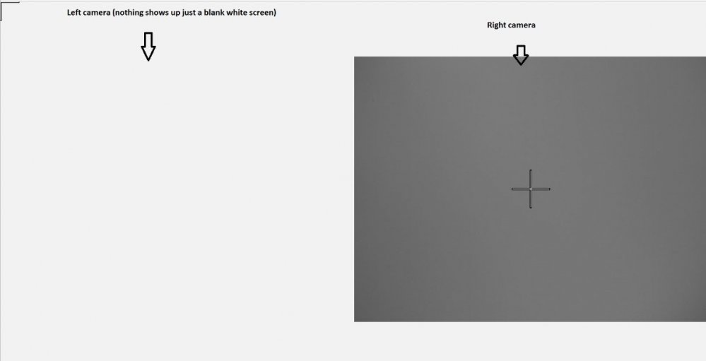

[2e...] Posted August 11, 2022 Share Posted August 11, 2022 I am using GOM 12M sensor System. While initializing the sensor through ARAMIS professional 2016 the left camera does not show anything and the screen area (in the image) is also white for the left camera. Only right camera shows up. I checked the deformation sensor part it seems no problem with the hardware since everything shows green indication. I repudated the ARAMIS 2016 through gom maintenance tool. Still problem couldn't fixed yet. Link to comment Share on other sites More sharing options...
[Iv...] Posted September 1, 2022 Share Posted September 1, 2022 It seems that you have a hardware problem. Please contact your local GOM Partner. Greetings, Ivan Link to comment Share on other sites More sharing options...
[Ma...] Posted October 19, 2022 Share Posted October 19, 2022 Good day, we had the same problem that the left camera did not show a picture and we could not measure. After a PC defect, the PCI-e cards were installed incorrectly, so that the network card for the cameras sat in a wrong slow slot. After changing the PCI-E cards, the problem was gone again. Maybe this is helpful for some users. (Picture shows wrong mounting condition) Link to comment Share on other sites More sharing options...
