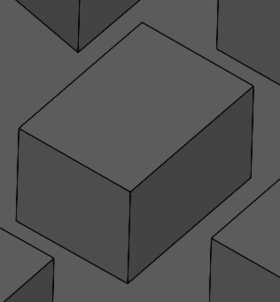

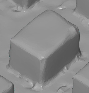

[Mo...] Posted August 12, 2022 Share Posted August 12, 2022 (edited) A part I am inspecting has a CAD model full of sharp edges. In reality, the part comes off the machine with rounded radii and the print specifies a max radius so I need to assign the radius a numerical value. What would be the most efficient way to determine the radius if it's not modelled in the CAD? CAD model with sharp edges: Actual mesh with rounded edges: TIA Edited August 12, 2022 Link to comment https://qualityforum.zeiss.com/topic/1255-how-to-inspect-max-radius/ Share on other sites More sharing options...
[Lu...] Posted August 24, 2022 Share Posted August 24, 2022 you can cut sections on mesh and create circles without the cad. create the circles with fitting circle command. then when you evaluate you most input the nominal size. Regards. Link to comment https://qualityforum.zeiss.com/topic/1255-how-to-inspect-max-radius/#findComment-4234 Share on other sites More sharing options...
