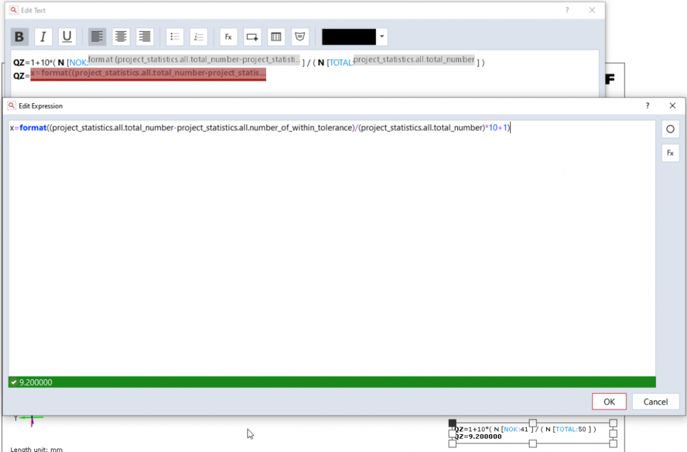

[Má...] Posted August 26, 2022 Share Posted August 26, 2022 Hello! I would like to round to 2 digits in a report text expression. I found round function but digits can not be setted. How is it possible to do this? In this example it supposed to be 9.20. Best regards, Máté Link to comment Share on other sites More sharing options...

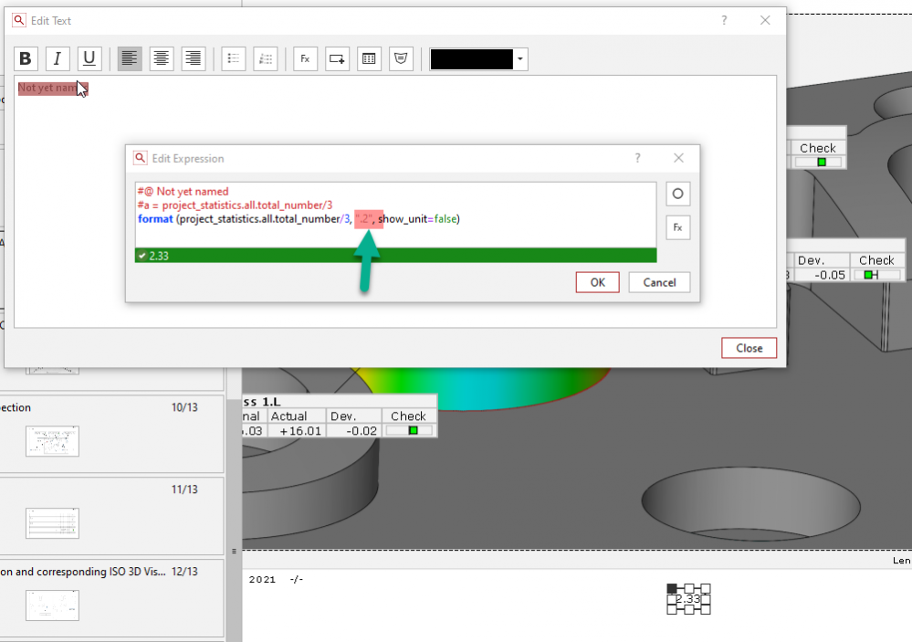

[Na...] Posted August 29, 2022 Share Posted August 29, 2022 Hi, under the Fx button is the string function, which has a parameter for digits: Link to comment Share on other sites More sharing options...
