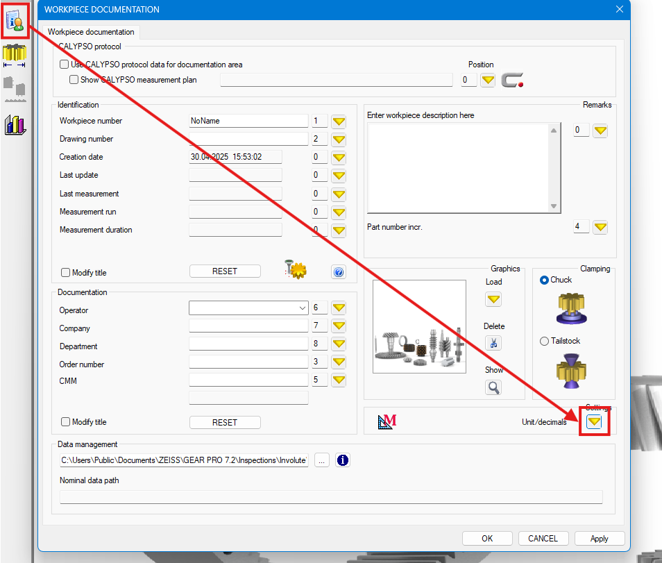

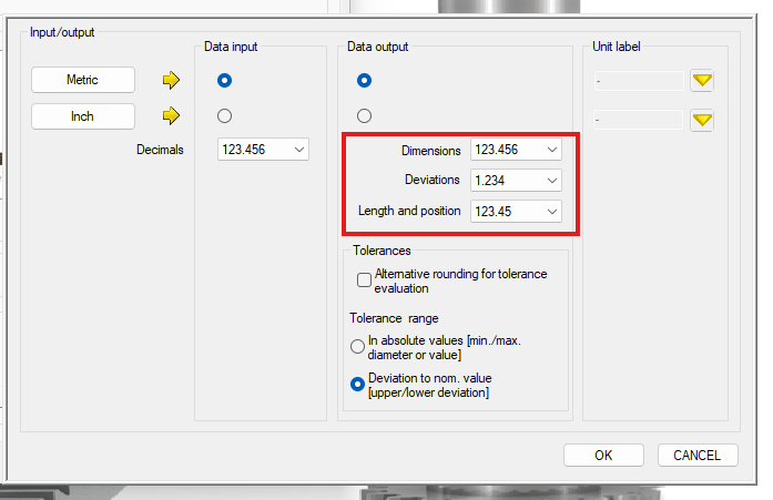

[Ky...] Posted April 30, 2025 Share Posted April 30, 2025 Hello Harald, I'm afraid I'm not completely up to speed on the context, but are you just trying to show more decimal places in the Gear Pro report or something? If so, I believe what you want is in the workpiece documentation area of the Gear program (at least that's it's English name). Again, I'm not sure of what language you are using with Gear Pro, but "Dimensions" generally refer to nominal values you set up in the program, deviations are for results (specifically things like profile and lead values that are a deviation from 0) and length and position refer to stuff like dimension between pins, if I remember correctly. Hope that helps. Link to comment Share on other sites More sharing options...

[Ha...] Posted May 7, 2025 Share Posted May 7, 2025 Please sign in to view this quote. That's is it. Thank you. Link to comment Share on other sites More sharing options...
