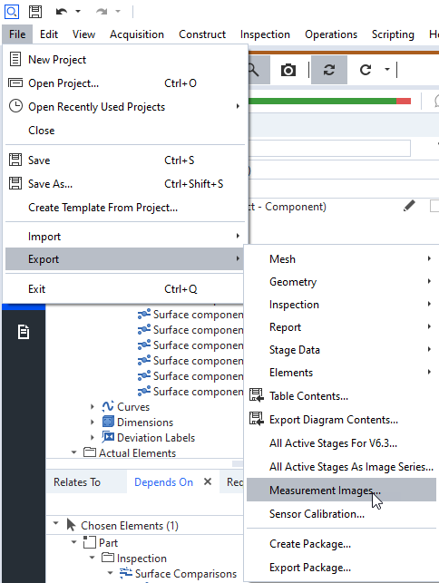

[He...] Posted September 4, 2022 Share Posted September 4, 2022 Hello, Is there any function that can extract tiff files that used to calculate strain at .gcorrelate file? Saving tiff images and .gcorrelate file simultaneously takes too much storage. Thanks. Link to comment Share on other sites More sharing options...
[Th...] Posted September 26, 2022 Share Posted September 26, 2022 Hi, you can either use File - Export - All images as images series (including some data for re-import in new projects) File - Export - Measurement images... Link to comment Share on other sites More sharing options...
[Ca...] Posted February 13, 2023 Share Posted February 13, 2023 Hello I would like to export images as a TIFF as well, but I don't have any of these options below "All Active Stages" I have a 2022 COM correlate PRO license, do you know what the issue is? Link to comment Share on other sites More sharing options...
