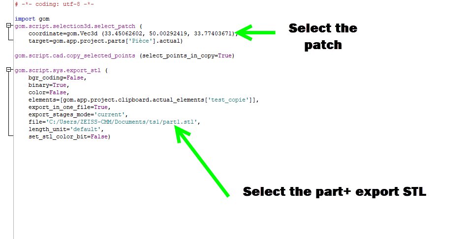

[DR...] Posted September 5, 2022 Share Posted September 5, 2022 Dear Friends , After scanning many parts in the same time, we need to do : polygonization select part (one part) copie the part export the part as STL file select another part copie the part export the part as STL file ... ... --> until finishing all the parts Is there any solution to this work automaticly with scription ? Thank you for your help Link to comment Share on other sites More sharing options...

[Na...] Posted September 8, 2022 Share Posted September 8, 2022 Hello Dridi, you can record your workflow with the record button in the script editor. After that you can edit the recorded commands and generalize them so they work with different part names/mesh names etc. You would probably start the script with a list of all parts in your project and then executing your steps for each part. Regards, Nanno Link to comment Share on other sites More sharing options...
[DR...] Posted September 8, 2022 Author Share Posted September 8, 2022 DEAR NANNO ; thank you for your answers ! I did that but how can I change the name of the part automaticly .I think I need to creat a Variable (n=n+1) . Part1 Part2 Part3 .... my probleme how to do this program ? Thank you in advance ! Link to comment Share on other sites More sharing options...
[Ja...] Posted September 8, 2022 Share Posted September 8, 2022 dridi, just my personal thought , I think you'll need to look into some python training from a few locations , there are plenty of good external sites as well as some offerings from gom . I think it is very hard to communicate the help you need on a forum . there isn't a generic way to handle such needs to to be able to provide an out the box solution unfortunately . the fact you say polygonisation required suggests you need to load project , polygonise , calculate reports /alignments , export stl, close project it is possible for python to iterate through files in a directory is by 'for' loops . Link to comment Share on other sites More sharing options...

[DR...] Posted September 9, 2022 Author Share Posted September 9, 2022 Link to comment Share on other sites More sharing options...
[Ja...] Posted September 9, 2022 Share Posted September 9, 2022 (edited) hey dridi, not sure why you are selecting a patch ? this is not a robust way , as you see it saves the co ordinates where you clicked. looking back at all your text I'm guessing, but it looks like you may have scans with multiple parts inside one stl and want to segregate ? this starts getting really tough because what is your logic about where the parts are in space about how the parts will be named? gom developed methodologies for measuring multiple parts at once that can get over some of these logic hurdles. but these need to be used at the point of scanning in 2021 . Edited September 9, 2022 Link to comment Share on other sites More sharing options...
[DR...] Posted September 14, 2022 Author Share Posted September 14, 2022 HELLO JAMES, yes the selection of the patch is not good . But i need after when I select the part , I can export directly the part with one click Link to comment Share on other sites More sharing options...
[Ja...] Posted September 14, 2022 Share Posted September 14, 2022 sorry Dridi, I'm not sure what you mean. I think it would be helpful to write out the logic steps that you have in mind . as I say it could be that you are trying to solve something that is already solved by different workflow methodology Link to comment Share on other sites More sharing options...

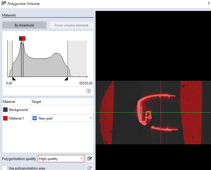

[Fe...] Posted November 29, 2025 Share Posted November 29, 2025 @马尔科·吉劳多Dear Mr. Gilardo, There is no need to remove the dialog box, but I have encountered other issues. Currently, after running the script, the program fails to recognize the correct grayscale values. Do you happen to have a script for extracting grayscale values? I am using GOM Volume Inspect Pro 2022. If you have a relevant script, I would greatly appreciate it if you could share it. Thank you. Link to comment Share on other sites More sharing options...
[Ma...] Posted December 4, 2025 Share Posted December 4, 2025 No, I don't use Volume Inspect, but what I see is that you have 2 different materials in the scan. I don't know why it recognize the first one as your material. Link to comment Share on other sites More sharing options...
[Fe...] Posted December 5, 2025 Share Posted December 5, 2025 @Marco Giraudo Dear Mr. Giraudo, This is a schematic diagram. My idea is to use a script to remove Material 1 and retain only Material 2. This way, I can quickly extract the correct material. Otherwise, I will have to manually extract Material 2. Link to comment Share on other sites More sharing options...
