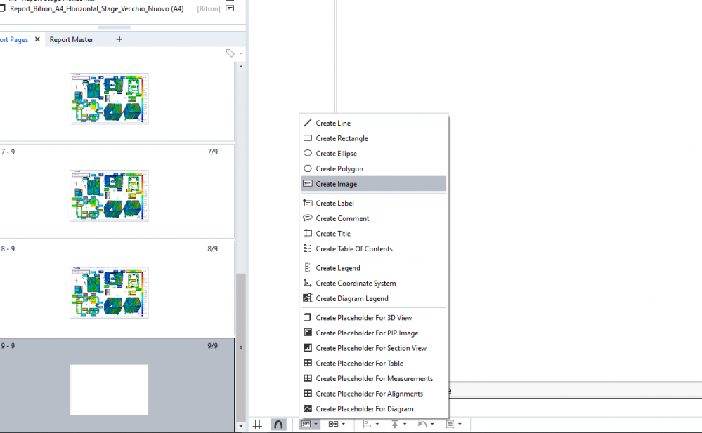

add drawing to my project
Hello Dridi,
there is no direct method to import PDF files into the project. But if you are familiar with the scripting environment you can use the "pymupdf" module to extract each page as an image, map it onto a plane and import both as an textured obj.file. I attached a simple script that does the job. You only have to install "pymupdf" with the InstallPythonPackage script from the script editor and use the attached script. With the zoom_x and zoom_y variable you can set the resolution of the image (default pdf is 72dpi)
Hope this helps,
Helge
