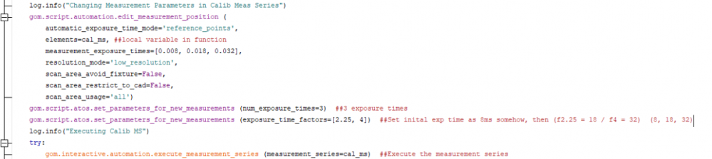

[Sa...] Posted October 7, 2024 Share Posted October 7, 2024 Hi, I recognize this is a pretty old discussion, but I'm also working on an application where I would like to set exposure times via the script. It would be possible to use the camera tab as usual, and I'll revert to that if I have to. But our users would prefer to stay in the script dialog, and setting the exposure times via the script feels like it should be easy to do. In my case, the record function gives me a bit more insight, gom.script.atos.set_parameters_for_new_measurements (exposure_time_factors=[3.0, 7.0]) but this still isn't enough information to know what those exposure times are. I can also get the full list of exposure times for current_measurement_exposure_time in gom.app.project.current_measurement_exposure_times: print(current_measurement_exposure_time) But I can't set them. RequestError: GScriptErr-0006 - Element "gom.app.project" does not have a settable attribute with the name "current_measurement_exposure_times". So, how do you set that first exposure time? Also, how do you set the reference point exposure time? Thank you! Link to comment Share on other sites More sharing options...

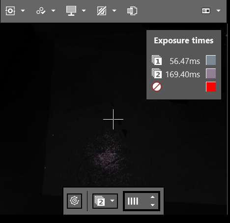

[Sa...] Posted October 9, 2024 Share Posted October 9, 2024 We're scanning with an ATOS 5. You're correct that we can't control the external environment. We are impressed at how minimally the ATOS 5 is affected by ambient light, but we're still not confident that one exposure time setting could work for every possible lighting condition. And our process is manual. I'm worried I may have made my goal sound more complicated than it really is. All I really want is for our users to be able to adjust exposure time explicitly (e.g. with a text box) and with a preview image. I would prefer to be able to do this from our UI, but even a command that pulls up the same dialog box as Digitize Workspace > Camera Tab > Exposure Time Mode (Interactive) > Exposure Times (User-defined) would still be preferable to having our users navigate the Camera tab unassisted. Is that possible? Link to comment Share on other sites More sharing options...

[De...] Posted October 16, 2024 Share Posted October 16, 2024 I wrote this a while ago to validate an offline scan box program; I wanted to set the exposure time to 8/18/32ms & I think I was having the same sorta issue; however if you edit the measurement position you can change it through "measurement_exposure_times=[x,x,x]" You can probably also set it through your scanning template(?) as others mentioned; exposure settings depend on the lenses aperture, ambient light, projector brightnes...etc.etc.. and will differ from sensor to sensor hope it helps. Link to comment Share on other sites More sharing options...
