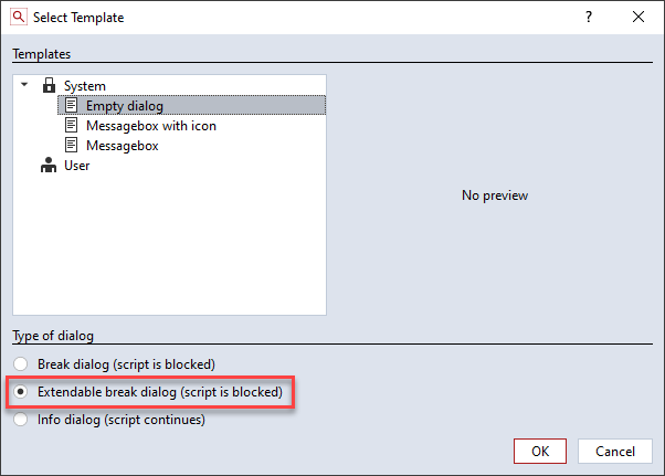

[Th...] Posted November 8, 2022 Share Posted November 8, 2022 Of course. Use "create_user_defined_dialog" instead of "execute_user_defined_dialog": Because there you can dynamically change the dialog's settings. See this code for reference: import gom import os DIALOG=gom.script.sys.create_user_defined_dialog (content='<dialog>' \ ' <title>Importa Figure di Riferimento</title>' \ ' <style>Standard</style>' \ ' <control id="OkCancel"/>' \ ' <position>center</position>' \ ' <embedding></embedding>' \ ' <sizemode>automatic</sizemode>' \ ' <size height="172" width="271"/>' \ ' <content columns="1" rows="2">' \ ' <widget row="0" type="label" rowspan="1" columnspan="1" column="0">' \ ' <name>label</name>' \ ' <tooltip></tooltip>' \ ' <text>IMPORTA FIGURE DI RIFERIMENTO</text>' \ ' <word_wrap>false</word_wrap>' \ ' </widget>' \ ' <widget row="1" type="input::file" rowspan="1" columnspan="1" column="0">' \ ' <name>directory2</name>' \ ' <tooltip>Scegli la Cartella</tooltip>' \ ' <type>multi_file</type>' \ ' <title>Scegli la Cartella</title>' \ ' <default></default>' \ ' <limited>true</limited>' \ ' <file_types>' \ ' <file_type name="*.stl *.g3d" description=""/>' \ ' </file_types>' \ ' <file_types_default>*.stl *.g3d</file_types_default>' \ ' </widget>' \ ' </content>' \ '</dialog>') # get your default path from somewhere my_path = r"E:\temp" # do this little trick to really go into the folder my_path = os.path.join (my_path, "_") # change the dialog content dynamically before executing the dialog DIALOG.directory2.default = my_path RESULT=gom.script.sys.show_user_defined_dialog (dialog=DIALOG) Link to comment Share on other sites More sharing options...
