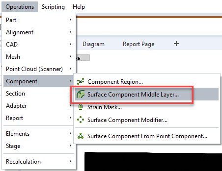

When you have the chance to update from ARAMIS 2018 to GOM Correlate/ARAMIS 2020 or higher I really recommend to do it and check a middle layer element instead of the outer layer surface component directly, because this will minimize the error in thickness calculation due to bending on radii. The middle layer element was introduced in GOM Correlate 2020.

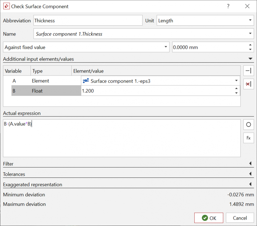

Hi Szabolcs,

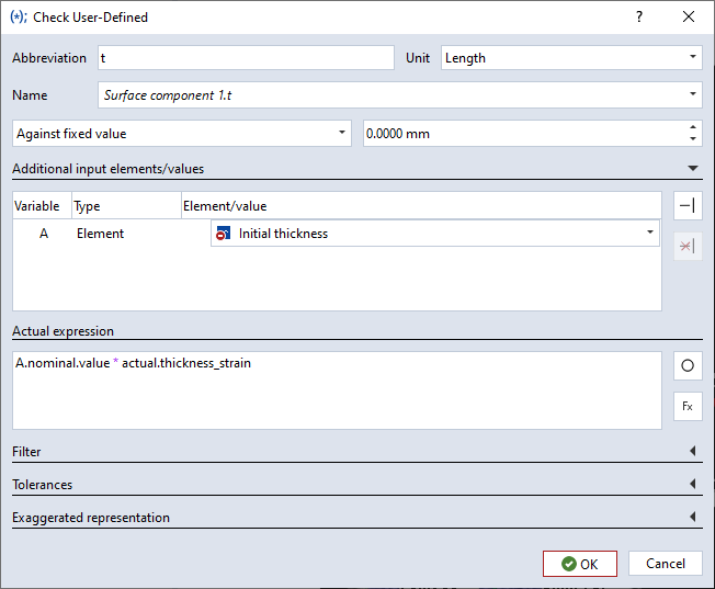

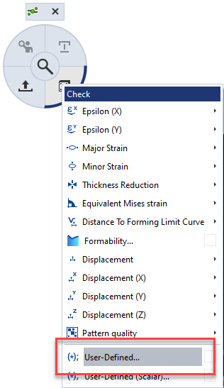

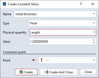

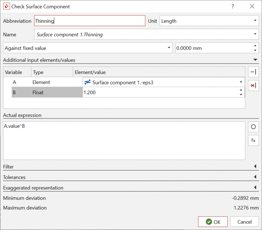

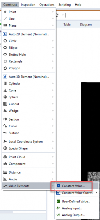

The change in thickness is calculated as a strain. If you would like to get the change in thickness in mm, or even the new thickness, you can use a User-defined inspection. First, inspect your surface component for Thickness Reduction (Inspect > Check Dimensions > Strains > Check Thickness Reduction). This inspection will be used in your User-defined inspection of the surface component. When creating your User-defined inspection, add two input elements into the "Additional input elements/values" section, then set one to your thickness reduction inspection and change the other from an "Element" type to "Float" type. This float value will be your material's original thickness. You can then define the actual expression to calculate the amount of thinning or the material's new thickness. I've attached some pictures that should be useful for you.
