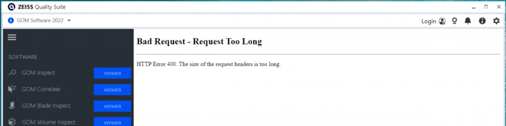

[Ma...] Posted October 25, 2022 Share Posted October 25, 2022 Hi I cannot log in to the 2022 suite. I get an HTTP Error 400 - Request too long. Tried flushing my DNS cache, but the internet says it might be a corrupt cookie in the browser, but I cant find anywhere to reset settings for the suite browser. I can access the Forum from the Suite. And is logged in automatically. Anybody had a similar issue? or even better a solution.. Link to comment https://qualityforum.zeiss.com/topic/1502-unable-to-login-http-error-400/ Share on other sites More sharing options...
[Na...] Posted October 26, 2022 Share Posted October 26, 2022 Hi Martin, please try deleting this folder: C:\Users\user\AppData\Local\CefSharp\Cache Link to comment https://qualityforum.zeiss.com/topic/1502-unable-to-login-http-error-400/#findComment-5028 Share on other sites More sharing options...
[Ma...] Posted October 31, 2022 Author Share Posted October 31, 2022 Hi Nanno. That did the trick. Thank you for the help! Link to comment https://qualityforum.zeiss.com/topic/1502-unable-to-login-http-error-400/#findComment-5076 Share on other sites More sharing options...
