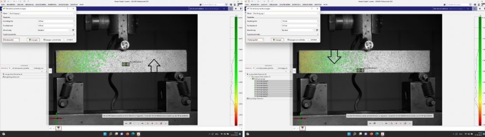

[Ph...] Posted October 31, 2022 Share Posted October 31, 2022 (edited) Hi, I am currently setting up an ARAMIS 12M system and came across this Problem. It seems like the System is only able to find a sufficient pattern quality on the "left" side of the sample, even if i rotate the sample by 180° the software doesn't like the (now) right side of my sample. (pictures below) I have already checked all the settings (distance, aperture, focus, light) and repeated the calibratrion with a good calibration deviation result. Did anybody else ever came across this problem or has any idea how to solve this? Thanks 🙂 Musterqualität 27_10_22.bmpFetching info... Musterqualität 180° rotation 27_10_22.bmpFetching info... Edited October 31, 2022 Link to comment Share on other sites More sharing options...
