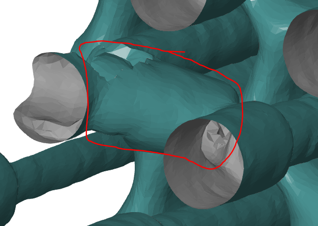

[Ad...] Posted November 2, 2022 Share Posted November 2, 2022 I'm currently inspecting CT scan data in Gom Inspect. I'm struggling with finding a good way to quickly find leaks in the data. Surface comparisons with CAD only go so far as I'm not really looking for deviations. Instead, I'm looking for small unexpected cracks, holes, and channels extending out of other as-expected channels. Any tips on how I can highlight these cracks, holes, and channels visually? Here is an example of a leak between two as-expected channels: Link to comment https://qualityforum.zeiss.com/topic/1526-finding-leaks-in-a-mesh/ Share on other sites More sharing options...

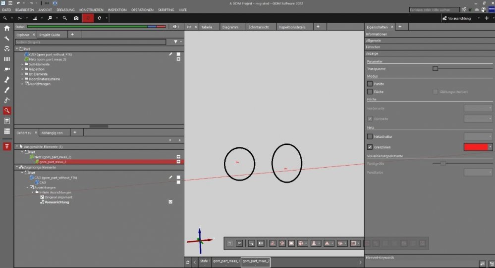

[Je...] Posted November 4, 2022 Share Posted November 4, 2022 Hello Adam, go to mesh, propertied, visualization: Disable "surface" Activate Mesh - Corner Lines (chose colour = red for example) Now only holes are visible which are marked red I (use white background for better contrast). Best regards, Jens Braun Link to comment https://qualityforum.zeiss.com/topic/1526-finding-leaks-in-a-mesh/#findComment-5126 Share on other sites More sharing options...
[Ad...] Posted November 7, 2022 Author Share Posted November 7, 2022 That's a good idea for finding breaks in the mesh itself. In my case, I'm trying to highlight unexpected channels in a solid mesh that doesn't have any corner lines. Link to comment https://qualityforum.zeiss.com/topic/1526-finding-leaks-in-a-mesh/#findComment-5156 Share on other sites More sharing options...
[Ad...] Posted November 7, 2022 Author Share Posted November 7, 2022 Is there a way to color a mesh based on the angle of each triangle's normal vector direction? This might help me identify unexpected channels. Link to comment https://qualityforum.zeiss.com/topic/1526-finding-leaks-in-a-mesh/#findComment-5158 Share on other sites More sharing options...
