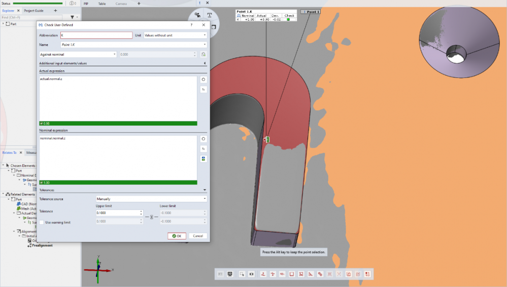

[Ju...] Posted November 3, 2022 Share Posted November 3, 2022 (edited) Hello everyone, I am looking to make a "user defined check" or a "custom label" to report out the I J and K values of surface points and circles. I would also like to be able to make a custom table to include these so they could be exported as a csv. Does anyone have experience with this or have any ideas on how to achieve this? I have uploaded a picture of an example label I am looking for. Thank you, Justin Dixon Edited November 3, 2022 Link to comment https://qualityforum.zeiss.com/topic/1532-reporting-i-j-k-values/ Share on other sites More sharing options...
[Be...] Posted November 23, 2022 Share Posted November 23, 2022 (edited) Hi, unfortunately, you must create I/J/K check as each separate user defined check. For the K-check it looks like this: Do not forget to add the check to the I-Inspect to reuse it. Hope this helps? Regards, Bernd Edited November 23, 2022 Link to comment https://qualityforum.zeiss.com/topic/1532-reporting-i-j-k-values/#findComment-5267 Share on other sites More sharing options...
