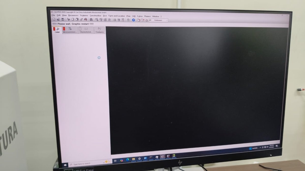

[CA...] Posted June 14, 2020 Share Posted June 14, 2020 Ja UNMÖGLICH, IMPOSSIBLE.... zu reintallieren die Calypso. Ich habe reinstalliert die Software um ich weiß nicht was zu tun um diese Fehler zu lösen. All the time the same message: Well, I have uninstall Microsoft SQL 2014, and the Calypso, all the package, so I made a clear installation of all. Now the problem when I Connect the Machine disappeared, but now after the creation of Stylus *.SSC we have a new problem With only 1 month more to prove the offline Planner.... What happen with the real License, too hard to install? We install here virtual machine, Database System in MySQL...., Operativ System Linux...but why is so hard with this simulator? Which Graphic need I to restart???? (look the uuper left corner in the above picture) I will test to import SSC Stylus with a Plan with a CAD model....Uhhhh nothing good, other problem, the software did not import CAD. Well, we will install the Service Pack 6.8.12....and to wait for!!! NOTHING....ServPack 6.8.12 and Update ZEISS_CALYPSO_2019_Patch_v6.8.1203.msp and the same or similar ERROR Well, ....so much errors for an installation... Now I will try with the error that constantly we got with the PC connected an CMM: ***********Scheme ACIS interface driver extension*************** Well, the same ERROR, it time to SAY goodby to offline Planner...in my Laptop ... At the end....all are problem in my Graphic Card, I'm sure....an Intel.... Well, we need an NVIDIA or something with high performance.... We have uninstalled all in offline site again, but no good luck with the trial version of Planner. Maybe in the dedicated PC if the manager decide to buy the license, but .... Link to comment https://qualityforum.zeiss.com/topic/15506-connection-failed-to-stylus-database/#findComment-83986 Share on other sites More sharing options...
[Zy...] Posted August 7, 2025 Share Posted August 7, 2025 I have similar issue on the Graphic Restart it doesn’t work with my HP Z4G4 with P1000, tried multiple drivers and got same error .. but works with the T1000 without any hassle Link to comment https://qualityforum.zeiss.com/topic/15506-connection-failed-to-stylus-database/#findComment-136485 Share on other sites More sharing options...

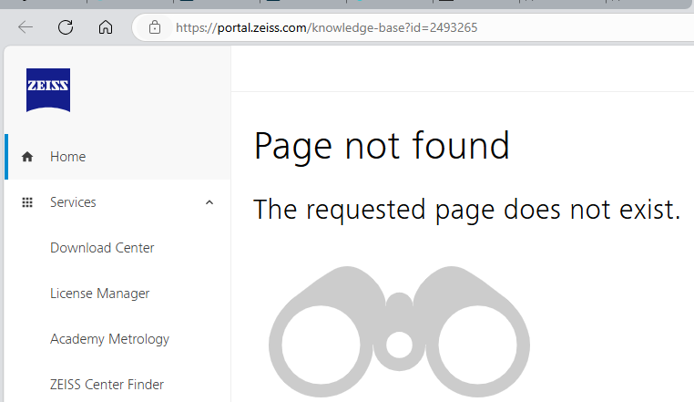

[Ab...] Posted August 8, 2025 Share Posted August 8, 2025 Hello Here are some troubleshooting for graphic restart error https://portal.zeiss.com/knowledge-base?id=2493265 Link to comment https://qualityforum.zeiss.com/topic/15506-connection-failed-to-stylus-database/#findComment-136561 Share on other sites More sharing options...
[Zy...] Posted August 11, 2025 Share Posted August 11, 2025 Hi Abbas, Could you share the guidance here ? I attempted to access the link you've shared but got this error Link to comment https://qualityforum.zeiss.com/topic/15506-connection-failed-to-stylus-database/#findComment-136573 Share on other sites More sharing options...
[Mi...] Posted August 11, 2025 Share Posted August 11, 2025 (edited) Please sign in to view this quote. https://portal.zeiss.com/knowledge-base?id=395504 Edited August 11, 2025 Link to comment https://qualityforum.zeiss.com/topic/15506-connection-failed-to-stylus-database/#findComment-136575 Share on other sites More sharing options...
