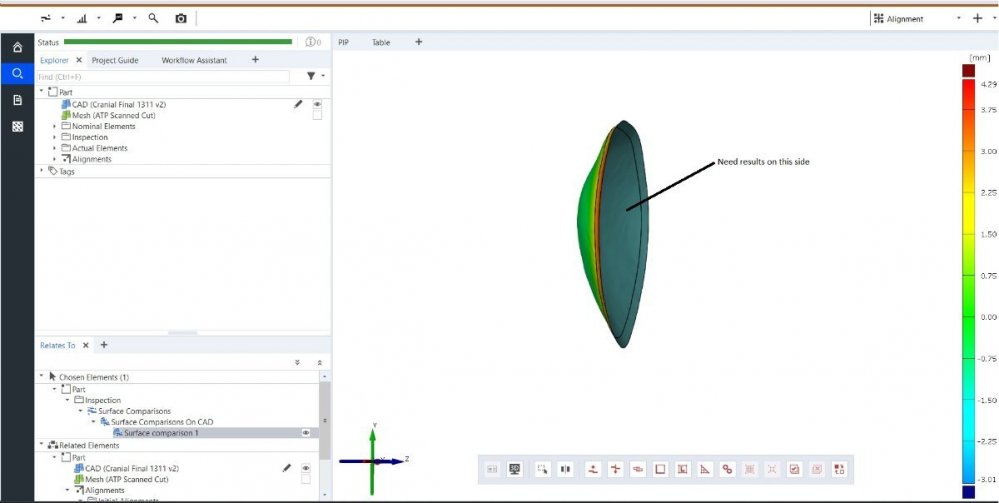

[Sa...] Posted November 15, 2022 Share Posted November 15, 2022 The side of the component that require surface inspection results to be displayed is rear side. How to interchange the front and rear side of the component. Or how to display the inspection results on the rear side of component. Link to comment https://qualityforum.zeiss.com/topic/1562-the-surface-inspection-results-on-other-side-of-the-part/ Share on other sites More sharing options...
[Ma...] Posted November 15, 2022 Share Posted November 15, 2022 I think your CAD has the normal inverted. You have to simply invert the surface using the command under Operation - CAD - Invert Patch Normal Automatically if all your CAD surface has the normal inverted. If only some of them are inverted you can select the patches with inverted normal and then invert it using the command under Operation - CAD - Invert selected patch normals. Link to comment https://qualityforum.zeiss.com/topic/1562-the-surface-inspection-results-on-other-side-of-the-part/#findComment-5216 Share on other sites More sharing options...
