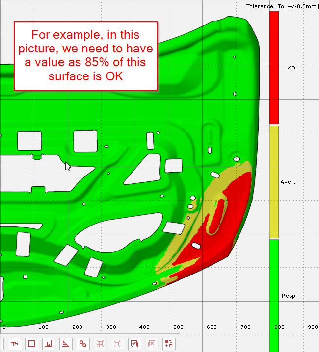

[Be...] Posted November 29, 2022 Share Posted November 29, 2022 Do you know if GomInspect is abbe to evaluate the rate of the surface who satisfy a tolerance like +/-0,5 after scanning. (answer like 85% of the surface is compliant of +/-0,5. Link to comment Share on other sites More sharing options...

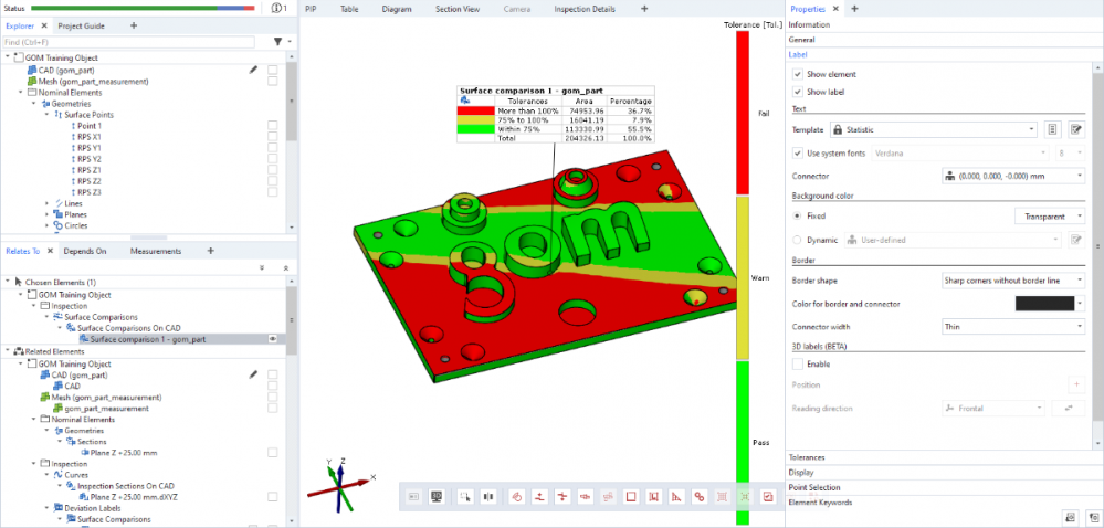

[Na...] Posted November 30, 2022 Share Posted November 30, 2022 Hello, there is the label template "Statistic", which shows the percentage: Regards, Nanno Link to comment Share on other sites More sharing options...
