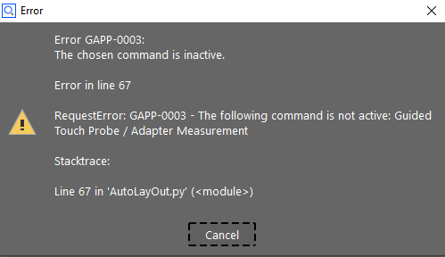

The command cannot be recorded. You have to type in its name by hand. Use
gom.interactive.probe.measure_guided_probe_or_adapter ()

 In response to this (I work with Gary), I tried the code you provided, and it keeps giving me the following error:
How do we correct this? We're in Live with the sensor initialized. Do we need to supply an element?
