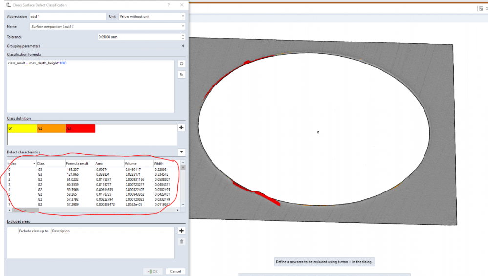

[To...] Posted December 5, 2022 Share Posted December 5, 2022 I have a 'deviation to geometry' element and one of the measurements you can do is a surface defect classification. This allows you to create a formula that categorizes the defects. When setting this up there is a table that lists all the defects and their individual properties such as volume, height etc. This is exactly what I need but I can't figure out how to display it in a report or even export it. When I show results it just hows a summary but I need a table of all the defects. Ideally with each defect labeled on the 3D view but this bit is not essential. I have uploaded an images showing the table I am referring to. Thanks for any help 🙂 Link to comment https://qualityforum.zeiss.com/topic/1615-how-do-i-show-all-results-from-surface-defect-classification/ Share on other sites More sharing options...
[Na...] Posted December 5, 2022 Share Posted December 5, 2022 Hello Tom, there is a package for this: https://connect.gom.com/display/GPF/Create+Surface+Defect+Checks Regards, Nanno Link to comment https://qualityforum.zeiss.com/topic/1615-how-do-i-show-all-results-from-surface-defect-classification/#findComment-5393 Share on other sites More sharing options...
[To...] Posted December 5, 2022 Author Share Posted December 5, 2022 Please sign in to view this quote. Hi Nanno, This is perfect, thanks for your help 🙂 Link to comment https://qualityforum.zeiss.com/topic/1615-how-do-i-show-all-results-from-surface-defect-classification/#findComment-5399 Share on other sites More sharing options...

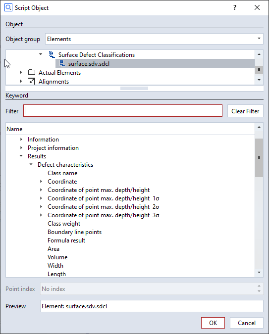

[Se...] Posted December 6, 2022 Share Posted December 6, 2022 Hi Tom, Values on the table are accessible via token -> information can be used to export the table values with the help of a script create user defined checks (like on the linked package) In scripting for example: Cheers, Sergio Link to comment https://qualityforum.zeiss.com/topic/1615-how-do-i-show-all-results-from-surface-defect-classification/#findComment-5413 Share on other sites More sharing options...
