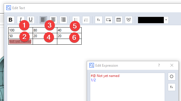

[La...] Posted December 21, 2022 Share Posted December 21, 2022 Hello everyone, Is it possible to perform mathematical operations as seen in the example in the picture? Link to comment https://qualityforum.zeiss.com/topic/1659-performing-mathematical-operations-such-as-excel/ Share on other sites More sharing options...
[Na...] Posted December 21, 2022 Share Posted December 21, 2022 Hello Latif, you can insert an expression with a right click and calculate inside it. Regards, Nanno Link to comment https://qualityforum.zeiss.com/topic/1659-performing-mathematical-operations-such-as-excel/#findComment-5549 Share on other sites More sharing options...
[La...] Posted December 21, 2022 Author Share Posted December 21, 2022 Hi Nanno, How do we define rows and columns? For example; How do I define a box named 1 and a box named 2? Link to comment https://qualityforum.zeiss.com/topic/1659-performing-mathematical-operations-such-as-excel/#findComment-5557 Share on other sites More sharing options...
