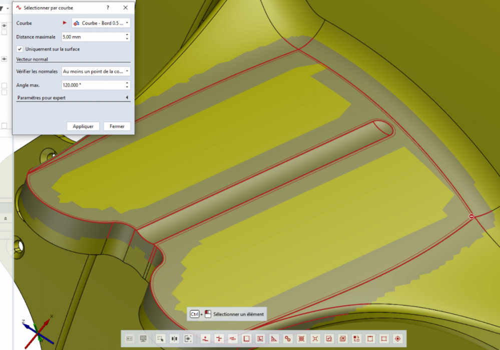

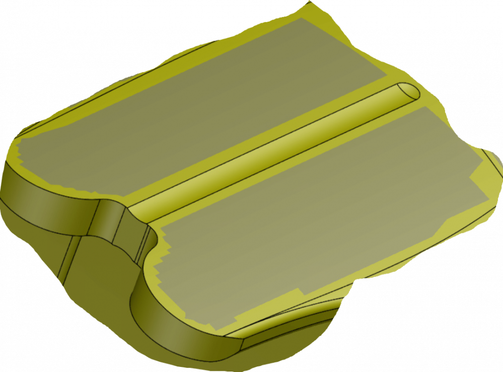

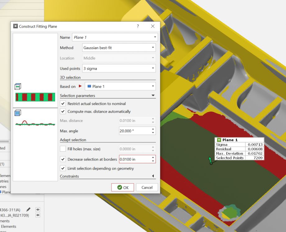

[Go...] Posted December 28, 2022 Share Posted December 28, 2022 Hello :-), I need to make a local CAD comparison with meshes of CAD model. But the model have sharps corners and the actual part doesn't, so the result isn't convincing : I would like to "exclude" the sharhe edge from my mesh selection. I tried to use a surface curve from 0.5mm of border but I can't make a surface selection "inside" it only "on" it: I would like a area selection ("manualy" done) like below : Do you have an idea ? Best regards, Sylvain Link to comment https://qualityforum.zeiss.com/topic/1665-local-cad-comparison-without-sharp-edges-of-cad-model/ Share on other sites More sharing options...

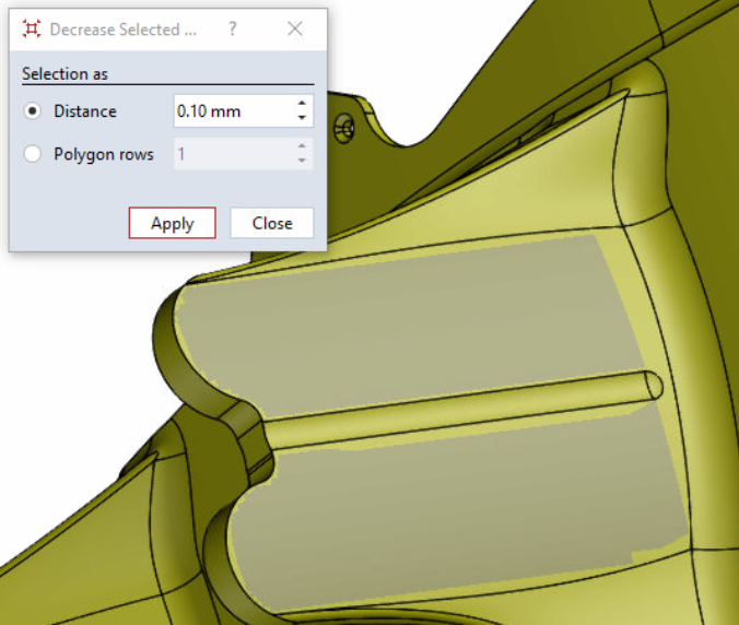

[Be...] Posted January 2, 2023 Share Posted January 2, 2023 Hi, Idea: Select patches on CAD Decrease the selected region with the according command Hope this helps?! Regards, Bernd Link to comment https://qualityforum.zeiss.com/topic/1665-local-cad-comparison-without-sharp-edges-of-cad-model/#findComment-5577 Share on other sites More sharing options...

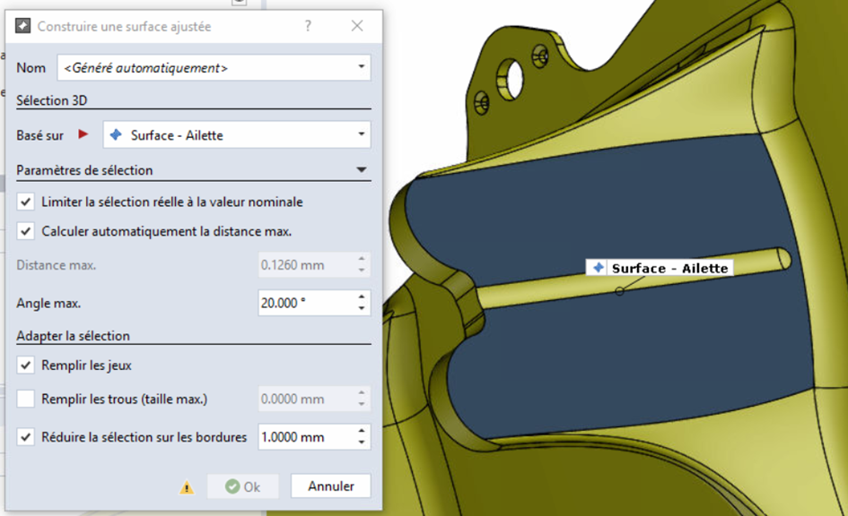

[Lu...] Posted January 5, 2023 Share Posted January 5, 2023 Edit the ACTUAL surface or geometry OR when you apply the Measuring Principle. look for the "Decrease selection at borders" option and check it. Link to comment https://qualityforum.zeiss.com/topic/1665-local-cad-comparison-without-sharp-edges-of-cad-model/#findComment-5619 Share on other sites More sharing options...

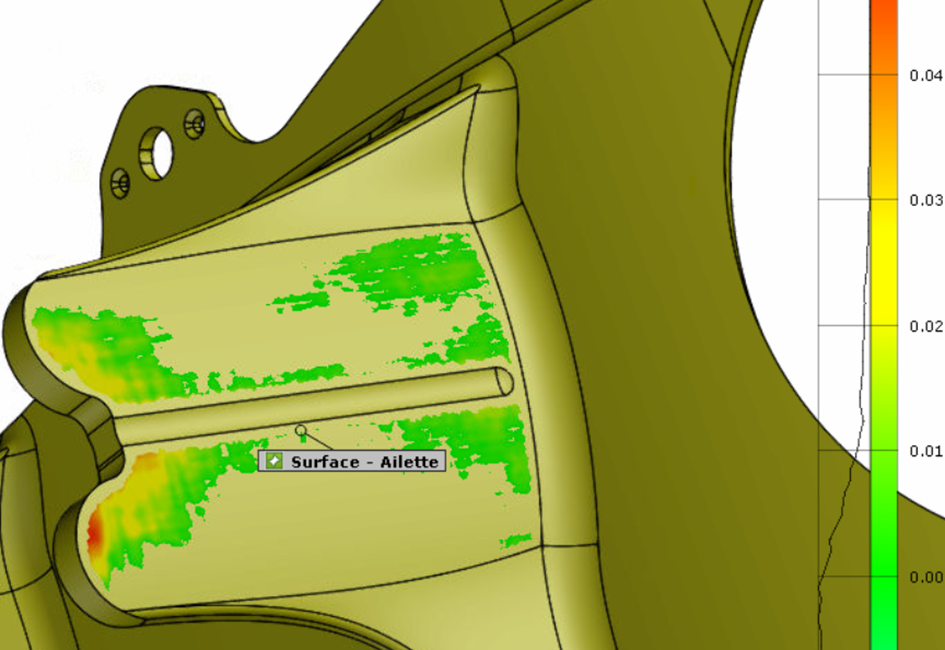

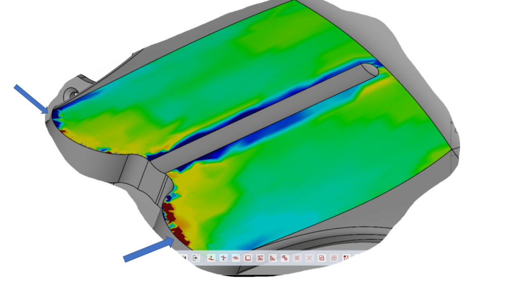

[Go...] Posted January 6, 2023 Author Share Posted January 6, 2023 Hello Luis, Thank you for your answer, it's exactly what I need ! I have constructed a Surface and apply Construct Fitting Surface method : Result : Best regards, Sylvain. Link to comment https://qualityforum.zeiss.com/topic/1665-local-cad-comparison-without-sharp-edges-of-cad-model/#findComment-5643 Share on other sites More sharing options...
[Go...] Posted January 6, 2023 Author Share Posted January 6, 2023 (edited) Please sign in to view this quote. Hello Bernd, Following to your message, my team mate (Aka Kevin) show me the Decrease Select Area : But I have chosen to make a fitting surface with Decrease selection at borders (see Luis' message) because it's more "accurate" for my need. Thank you for your answer. Best regards, Sylvain. Edited January 6, 2023 Link to comment https://qualityforum.zeiss.com/topic/1665-local-cad-comparison-without-sharp-edges-of-cad-model/#findComment-5645 Share on other sites More sharing options...
[Lu...] Posted January 6, 2023 Share Posted January 6, 2023 Sylvain, If you going to work on the CAD make sure the "CAD triangulation parameters" is appropriate. Also i found that some times it will not do it on the Actual data. Regards Link to comment https://qualityforum.zeiss.com/topic/1665-local-cad-comparison-without-sharp-edges-of-cad-model/#findComment-5653 Share on other sites More sharing options...

[Mi...] Posted February 1, 2023 Share Posted February 1, 2023 (edited) This might not be an option for you, but when I run into this issue, I create radii on the edges of the CAD model. I'll generally take a quick measurement of the scan object radius first, then go into NX and put edge radii of that same size where I need them on the CAD model. Edited February 1, 2023 Didn't mean to say CAD Link to comment https://qualityforum.zeiss.com/topic/1665-local-cad-comparison-without-sharp-edges-of-cad-model/#findComment-6706 Share on other sites More sharing options...
