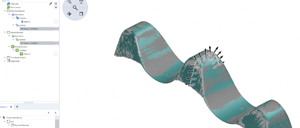

I am trying to measure the profile of a line using a section cut made across the center of the part with respect to a datum system A which is the center axis defined by the OD. When trying to do this, I receive an error MCADGps-4016 on Inspect 2021.
This is the defined section cut across the part:

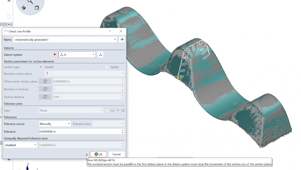

This is the error I receive when trying to check the Profile of Line with respect to the defined Datum system A:
