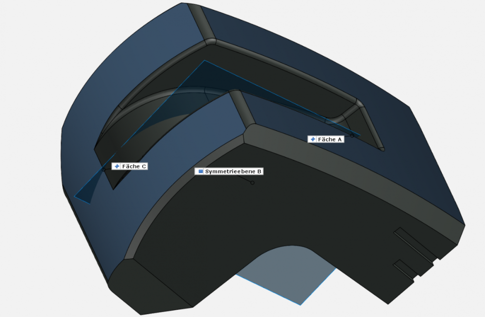

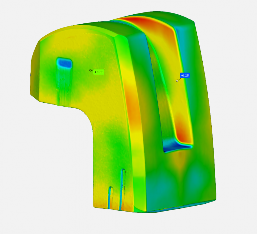

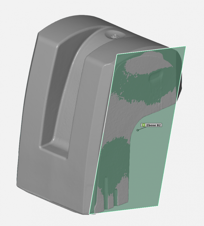

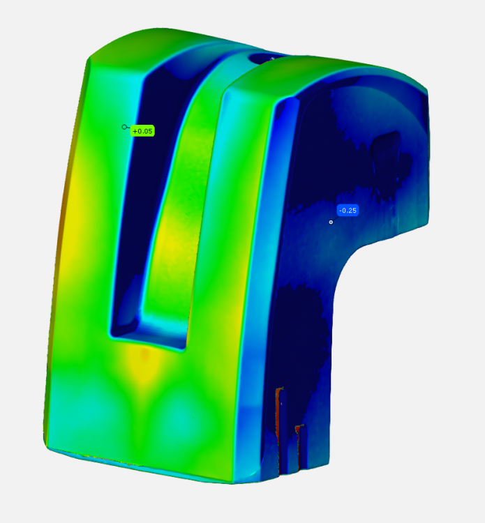

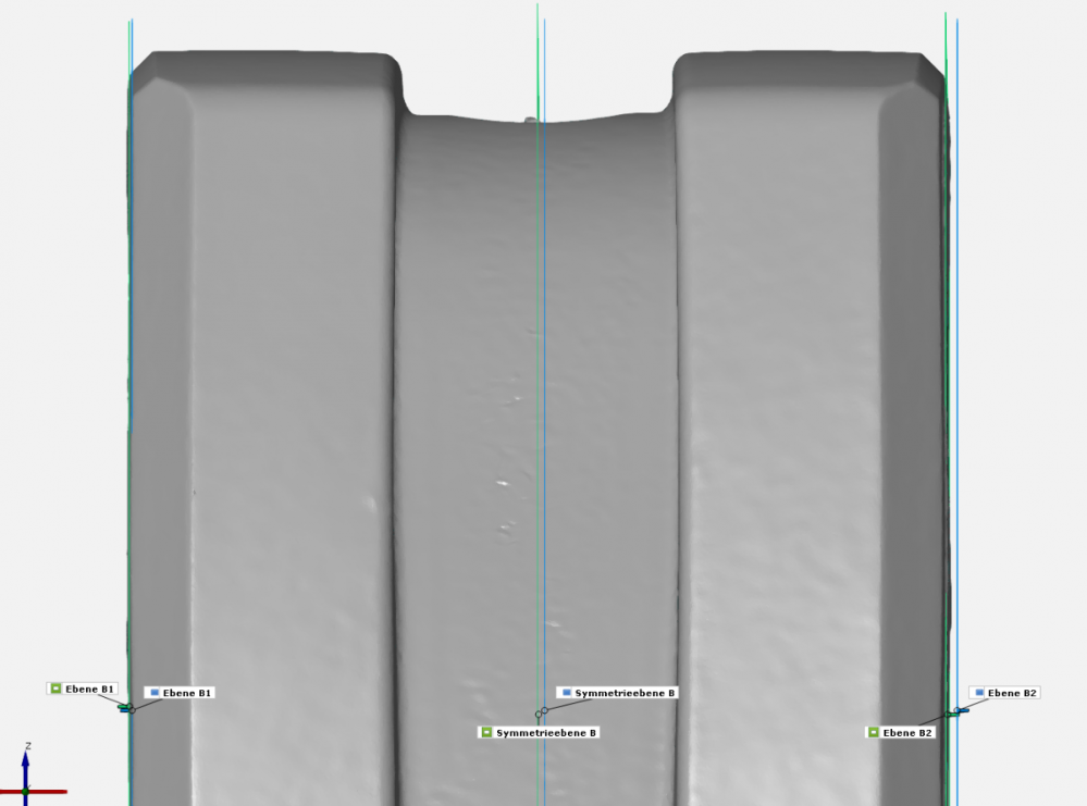

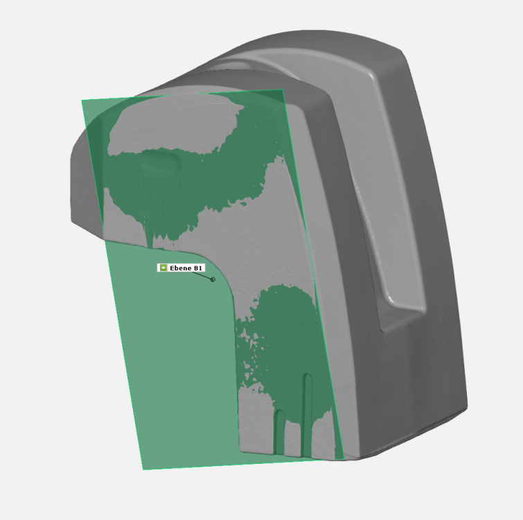

[b1...] Posted April 13, 2021 Share Posted April 13, 2021 Hello everybody! I have a part that is to be aligned over 2 surfaces and a symmetry plane via bestfit. I have created 2 fitting planes and from them a symmetry plane. But my part is not centered. Deviation is/should be elements. Does anyone have ideas why my deviation does not show the same results on both sides? Thanks in advance! Link to comment Share on other sites More sharing options...
[Be...] Posted April 14, 2021 Share Posted April 14, 2021 Hi, if you want to align your actual data via derived geometric elements you should use an alignment like Geometric alignment or something comparable (e.g. RPS, 3-2-1, ...). This is usually the best approach! I can only guess why the Bestfit does not compute the "expected" result: May be the Maximum search distance is not set accordingly or you can try to disable the Auto-adjust search distance in the Expert parameters. Hope this helps?! Regards, Bernd Link to comment Share on other sites More sharing options...
