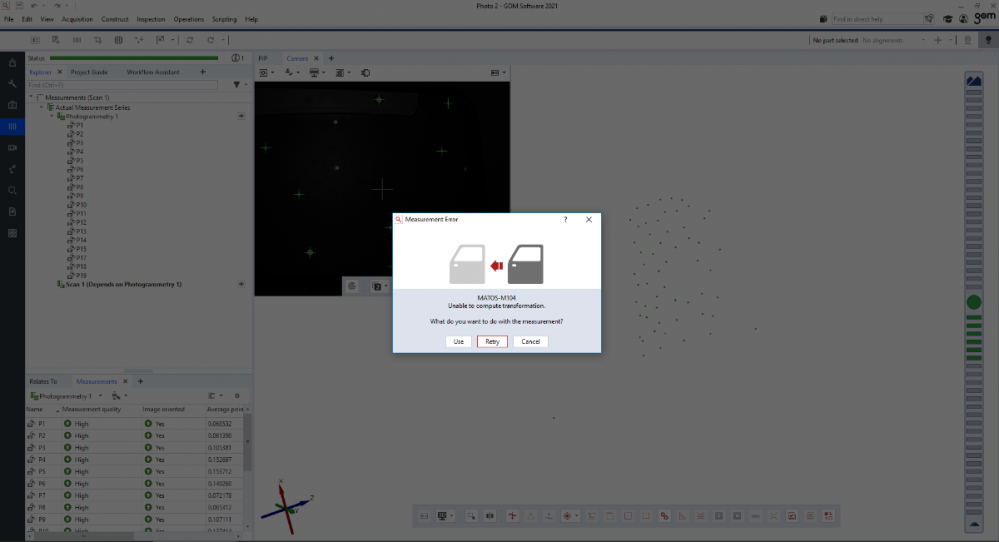

[Ha...] Posted January 12, 2023 Share Posted January 12, 2023 Hello, I have pre-measured photogrammetry reference point and I want to align the a scanning data on them/ depending on them. I couldn't do that and I got the below error. Link to comment https://qualityforum.zeiss.com/topic/1704-scanning-depending-on-old-pre-measured-photogrammetry-reference-point/ Share on other sites More sharing options...
[Ja...] Posted January 12, 2023 Share Posted January 12, 2023 This could suggest that your setup doesnt match the old pg setup . Can you redo the pg and see if the error is resolved ? Link to comment https://qualityforum.zeiss.com/topic/1704-scanning-depending-on-old-pre-measured-photogrammetry-reference-point/#findComment-5700 Share on other sites More sharing options...
