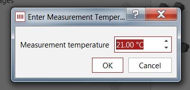

I'm trying to automate a scanning & inspection template and when the scanning first starts, I sometimes get this pop-up dialog (see photo). One has to hit "OK" and then the scanning begins. Recording these actions in the script editor does not result in any code, so I'm wondering if anyone knows how to write a line of code that hits "OK" on this dialog box. Alternatively, does anyone know how to get rid of this pop-up box altogether?

You can set a Temperature and ATOS will never ask you again before you start a measuring.
Go to Edit > Preferences > Hardware > Temperature and set a fix room temperature.
We got the same problem as you and we've found the settings few days ago ?
