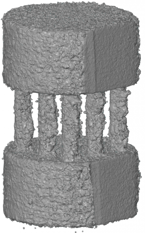

[Ma...] Posted April 22, 2021 Share Posted April 22, 2021 Hello, I am looking to measure the cylindricity of the 9 struts shown in the image. However, selecting the data of the interior struts for cylinder fitting is proving difficult. Does anyone know of a way that I can segment these struts out of the whole mesh so that I have a different region for each strut? Link to comment https://qualityforum.zeiss.com/topic/188-mesh-segmentation/ Share on other sites More sharing options...

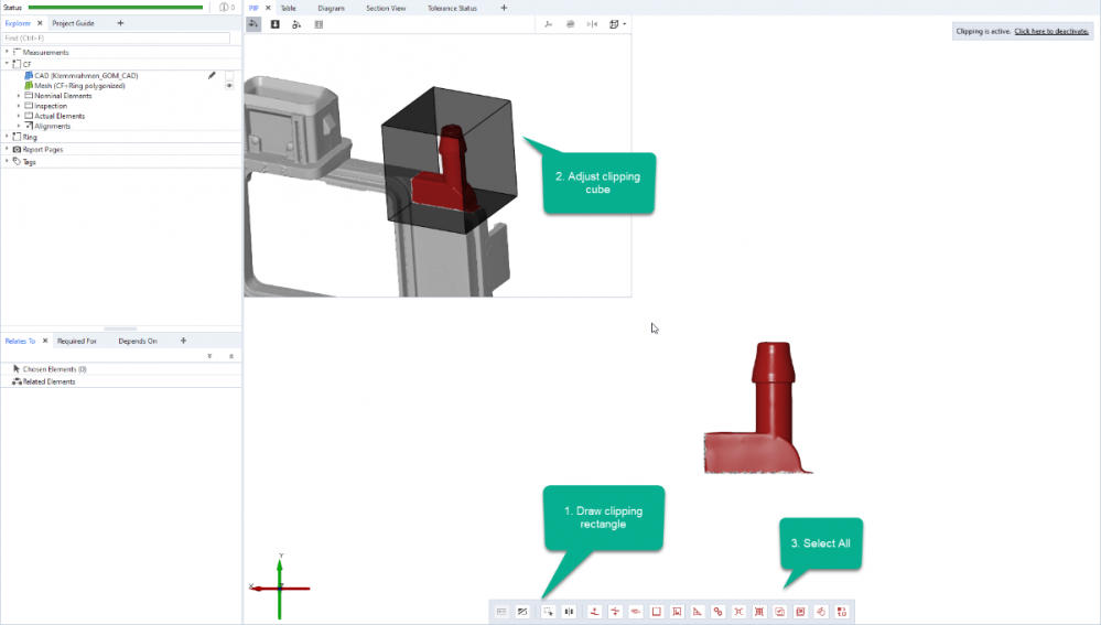

[Na...] Posted April 23, 2021 Share Posted April 23, 2021 Hello Maxwell, you could draw a clipping rectangle around one of the struts. In the PIP (Picture In Picture) you can click on the clipping cube and adjust the size and location to only show one strut at a time. Regards Nanno Link to comment https://qualityforum.zeiss.com/topic/188-mesh-segmentation/#findComment-534 Share on other sites More sharing options...
[Ma...] Posted April 29, 2021 Author Share Posted April 29, 2021 Nanno, that worked perfectly. Thank you for your help! -Max Link to comment https://qualityforum.zeiss.com/topic/188-mesh-segmentation/#findComment-561 Share on other sites More sharing options...
