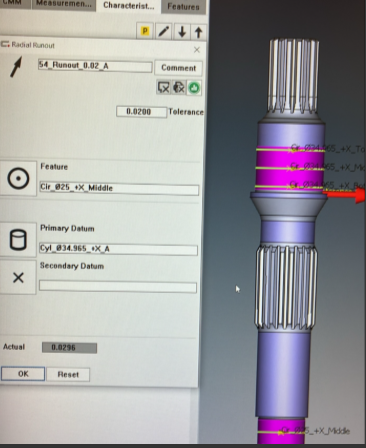

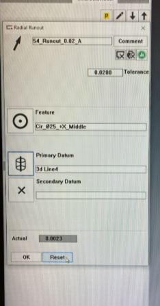

[Jo...] Posted February 10 Share Posted February 10 I have the following question regarding runout. My question is: the datum A should be a cylinder or a 3Dline? because I have different results according the way I apply the datum: They are both supposed to be an axis, what is the difference? Do you use a 3D line or a cylinder? Link to comment Share on other sites More sharing options...
[Do...] Posted February 11 Share Posted February 11 I too am curious about this topic as I work with very similar parts. Hopefully one of the forum gurus can chime in here. Couple of questions: Is your 3d line being constructed using recall or recall feature points? What is the length of the generated line? Recall: Returns the reference point(s) (the origin of the local feature alignment) of one or more features. I believe in this case it would evaluate each level of the cylinder as LSQ to derive a center point. A 3d line would then be constructed through those three points. Recall one feature: Returns the entire feature. This method should utilize all points taken and try to make a best fit line among all points in the feature. Recall feature points: Returns individual points, individual paths, specific areas (specified in coordinates) or all points of one of more features or one file. In this case, I would suspect the result to be the same as recalling the singular feature unless you decided to skip sections of the cylinder. As far as I understand, 3d lines would be generated off of your point selection and would not inherit any filters/outliers that would have been used on the Datum. The Datum axis is extended infinitely, however, the 3d line length can be set manually. Link to comment Share on other sites More sharing options...
[Ma...] Posted February 11 Share Posted February 11 It depends on drawing - if you have drawn datum A anywhere on cylinder and dimension, then it's a cylinder. If it would be exactly on dimension line ( at number ) then it would be a circle. But difference in using a 3d line and a cylinder can be by how you have created that 3d line. Link to comment Share on other sites More sharing options...
[Ri...] Posted February 11 Share Posted February 11 Please sign in to view this quote. The first thing I would look at is your evaluation settings. Your Cylinder could be switching to functional Datum, so OTE (min circumscribed on an OD). The 3d Line would pull from the feature setting of the circles you are recalling from. Link to comment Share on other sites More sharing options...
