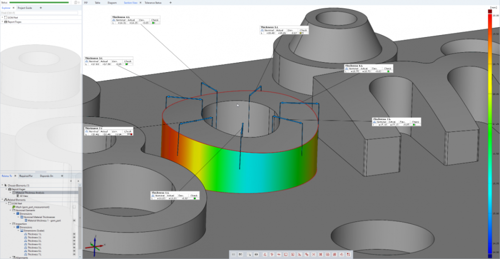

[Yo...] Posted May 3, 2021 Share Posted May 3, 2021 I am trying to measure thickness in a certain section. I have used INSPECTION -> Check Dimensions -> Positions -> Check dXYZ. If I check "Consturct 2-Point Line" the distance is 0.7600 in normal and 0.6848 in Actual. This should give me Dimensions (Scalar) of 0.0752 but the result is shown as 0.0085. Why would this happen? Link to comment https://qualityforum.zeiss.com/topic/201-dimesion-inspection/ Share on other sites More sharing options...
[Yo...] Posted May 3, 2021 Author Share Posted May 3, 2021 I noticed that there is an error. The alignment is not valid in this stage. How can I correct this error? Link to comment https://qualityforum.zeiss.com/topic/201-dimesion-inspection/#findComment-574 Share on other sites More sharing options...
[Yo...] Posted May 3, 2021 Author Share Posted May 3, 2021 After contructing measurement and check, it all works fine now. Link to comment https://qualityforum.zeiss.com/topic/201-dimesion-inspection/#findComment-575 Share on other sites More sharing options...
[Na...] Posted May 4, 2021 Share Posted May 4, 2021 Hello Yon, looks like you found the error. Maybe the dedicated tools for material thickness in our software are worth a look? Regards, Nanno Link to comment https://qualityforum.zeiss.com/topic/201-dimesion-inspection/#findComment-580 Share on other sites More sharing options...
