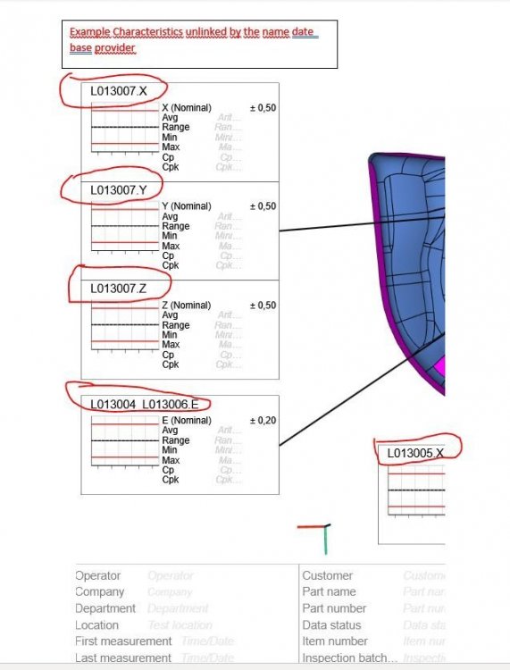

[Fr...] Posted November 13, 2024 Share Posted November 13, 2024 (edited) Hello everyone Let me see if you can help me with this question When creating in Piweb Designer a 15 page report template with the measurement results exported from Gom inspect or holos, I am finding that after some time this reference changes version (last letter). For example before it was 5JA 987 599 AD and now it becomes reference 5JA 987 599 AE. The only change in the whole program has been a dimension of a hole and a tolerance and the problem that I am finding is that all the structure and contents of the report lose the links, so I have to enter in each of the 200 characteristics, click on the Remove date binding option and associate it again to the reference with the new level. Is there any way that all the flags of the report pages are automatically linked to a reference selected from the provider database ? Thanks Francisco Edited November 13, 2024 Link to comment Share on other sites More sharing options...
[Do...] Posted February 3, 2025 Share Posted February 3, 2025 Hi, you can use the function "change common part..." in the designer. Open the designer -> Tools -> Change common part..." Link to comment Share on other sites More sharing options...
