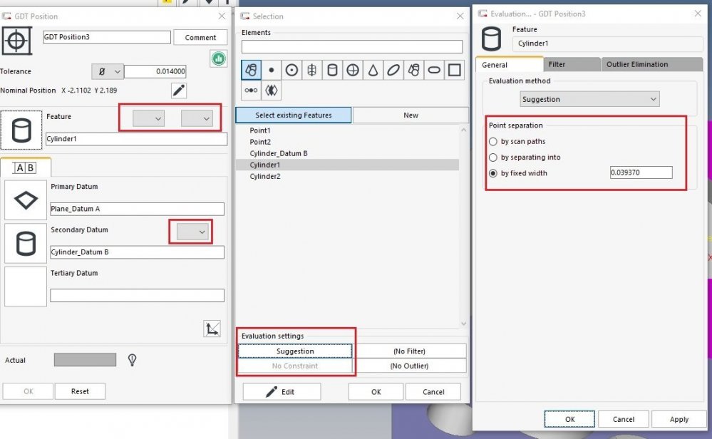

[To...] Posted November 19, 2024 Share Posted November 19, 2024 I'm starting to play around with the Beta GD&T Engine in Calypso 7.8.08, in particular the GDT Position of several cylinders with Simultaneous Requirement. Setting up the SimReq is not the issue. However, trying to find an efficient way to set up the evaluations per ASME Y14.5 is where I need some help. Please feel free to correct me on any of my statements. First off, the settings in Extras > Measurement > Form Datum, i.e. Outer Tangential for new Datums, or Ref Calculation per ISO 5459 do not pertain to the Beta Version. In other words, the evaluations on Datum Features come in as "Suggestion". What does this even mean? You need to convert every datum feature to Outer Tangential or the proper inscribed or circumscribed evaluation (there is no OTE option for cylinders). Even the considered feature, should be evaluated using OTE. What does the "Point Separation" option do? The secondary and tertiary datum features also come in with "no constraints" and there is no option to activate them. Does that mean that Calypso automatically applies the constraint rules of ASME? Would it not make sense for Calypso to automatically apply all of the proper evaluations and constraints to meet ASME? Having to check each and every option and setting WASTES time and money. If there are settings that take of this, I'd appreciate someone pointing this out for me. Below are some minor oddities. The options for setting RFS/MMC/LMC and Projection is blank (or not showing any default Default, i.e. RFS). The same applies for a datum feature of size and the options are MMR and LMR. What is MMR? 1 Link to comment https://qualityforum.zeiss.com/topic/21272-beta-gdt-engine/ Share on other sites More sharing options...

[Ri...] Posted November 22, 2024 Share Posted November 22, 2024 Tom, I am confused, when you have it set to ASME or ISO it is using what the Standard is saying you should use - that is what the Suggestion is. You can click on the light bulb at the bottom to see what evaluation methods it is using. As for the ISO5459 requirements, I believe it is applying this be default. I have compared results out of the new GD&T engine and Inspect using the same data set. For the most part, if you are wanting to follow the standard, there isn't a lot of work that needs to be done. At least Calypso allows you to change the evaluation parameters, Inspect isn't as friendly. Lol. Link to comment https://qualityforum.zeiss.com/topic/21272-beta-gdt-engine/#findComment-121690 Share on other sites More sharing options...
[To...] Posted November 22, 2024 Author Share Posted November 22, 2024 Please sign in to view this quote. Richard, Thank you for explaining things. The light bulb was very helpful, though there wasn't any indication of a datum shift. (Even in the Default Printout). I don't even know how other software programs handle this. I feel the term "suggestion" is a bit confusing. Why not just show what the actual evaluation is. Can you control the output of the diameter characteristics used for the MMC and MMB? It automatically adds these characteristics without the ability to rename it or control where they should be in the report. It appears you will need to duplicate the characteristic if you want to use a particular name or have it in a particular location. On the topic of names, is there a way to control the output of the characteristic names and the addition of (SimReq1)? I suppose, I could create a custom template to allow for longer names. Link to comment https://qualityforum.zeiss.com/topic/21272-beta-gdt-engine/#findComment-121700 Share on other sites More sharing options...
