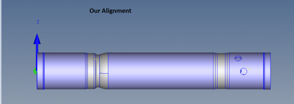

[BH...] Posted November 20, 2024 Share Posted November 20, 2024 Hello, I am working on a program sent from our customer who wants us to use their program to verify dimensions as their are discrepancies in our results. They have a different fixture set up then ours, so we have difference of alignment. I have a query about how can I rotate the alignment of the tube to match to our alignment, so it can also match all the existing features as well. Since, I am using special feature from base alignment (used rotation by angle option), all the hole features are keeping their original positions. Is there any way, I can rotate the orientation while also moving the features along with it. Link to comment Share on other sites More sharing options...
[Ma...] Posted November 21, 2024 Share Posted November 21, 2024 I think it doesn't matter while you will use same features. It seems they are using left hole as +Z and you are using right hole as -Y. If drawing is using ABC alignment, then you sould be fine - no matter how is basic alignment done. Link to comment Share on other sites More sharing options...
