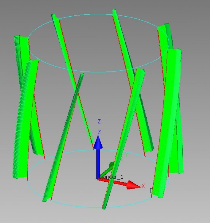

[Kl...] Posted November 21, 2024 Share Posted November 21, 2024 Selfcentering is only available inside standard element, like circle, line, and cylinder. Measure 8 sections inside cylinder and recall points to use it inside curve. By using rotary table its easier, only one stylus is necessary, because the sections is rotated to the stylus. Otherwise you have to use 8 stylus or split some section into subsections according to the stylus. Link to comment Share on other sites More sharing options...

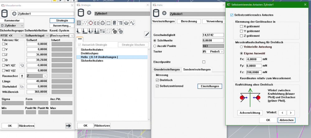

[Ma...] Posted November 22, 2024 Author Share Posted November 22, 2024 Ok now i have other problems In my standard settings for the self-centering touch, Fz is specified as -200mn. If I run the program like this, the machine goes into collision because it touches somewhere in Z and moves in the minus direction. If I change it to +200mn, the machine moves to the correct Z height but hits the part too hard in X. Without self-centering, the stylus travels cleanly along a helical path but does not hit exactly the middle of the oil groove Link to comment Share on other sites More sharing options...

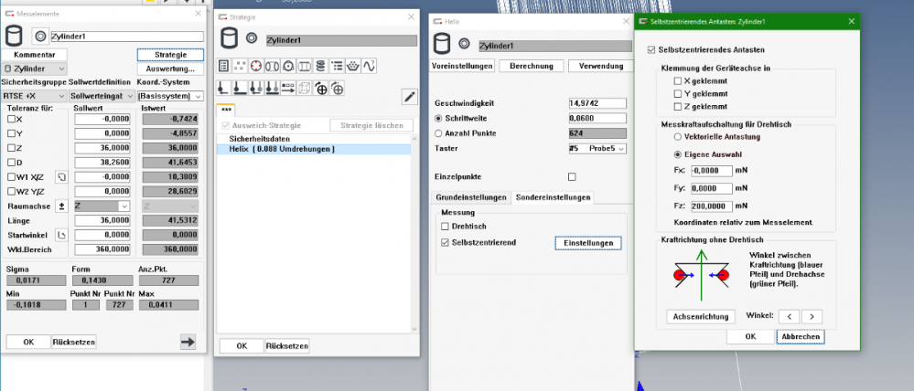

[Ma...] Posted November 22, 2024 Author Share Posted November 22, 2024 This is the result without rotary table. Link to comment Share on other sites More sharing options...
[Ri...] Posted November 22, 2024 Share Posted November 22, 2024 Considering this is a 3d self-centering, I wouldn't use the Own Selection - I'd leave it on the Probe In Normal Direction setting. With your current settings, it is applying all of the force downward, which is not what you want. The Direction of force without rotary table is correct. Link to comment Share on other sites More sharing options...

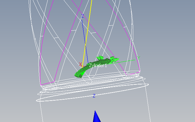

[Ma...] Posted November 25, 2024 Author Share Posted November 25, 2024 As can be seen from the green actual points, the problem is that the Stylus always slips out of the groove. No matter the diameter of my measuring ball, the self-centering does not work. Does this have something to do with the probing force in the vectors? I had another idea: i used the rotary table to create a self-centering point at the start and end of each groove and then connect the start and end points with a 2d-line. The problem here was that the points were always in the same place. So the line just went straight down. I had no angle/helix Link to comment Share on other sites More sharing options...
