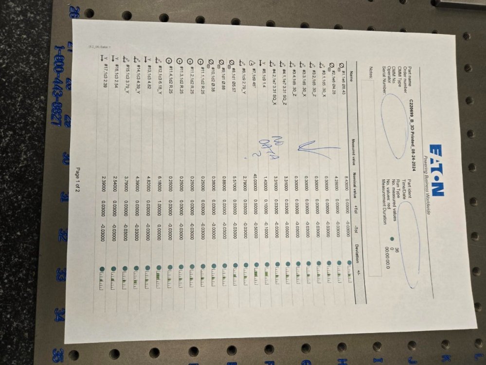

[Ri...] Posted November 22, 2024 Share Posted November 22, 2024 I am running into occasional issue where PieWeb doesn't fill in the data fields when the report is generated. (Usually, F7 refreshes the data, and it becomes populated). See attached image. Other than instructing a user to view the report prior to printing, is there a known issue or fix? It seems operators are sometimes blind to viewing reports. Link to comment Share on other sites More sharing options...

[DW...] Posted January 15 Share Posted January 15 Please sign in to view this quote. In PiWeb monitor, drop down the Tools menu. Is Auto Fetch Data checked? What about Automatically Update Page>Update Automatically? Link to comment Share on other sites More sharing options...
[Ri...] Posted January 16 Author Share Posted January 16 Yes, Auto Fetch, Auto Update are enabled. Link to comment Share on other sites More sharing options...
