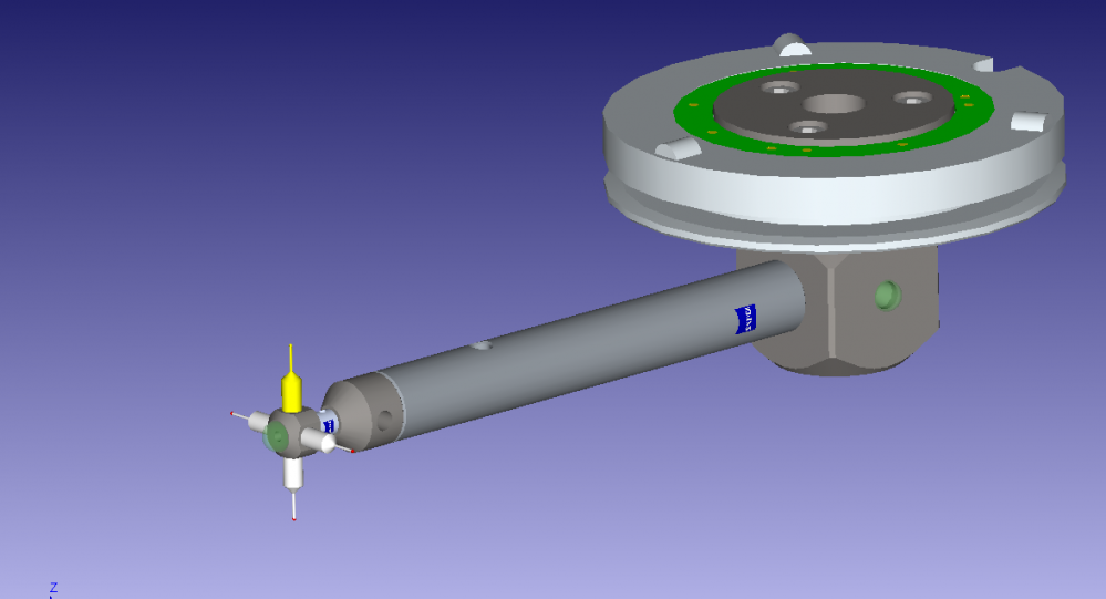

[Mi...] Posted December 9, 2024 Share Posted December 9, 2024 We've gone away from discs to mini stars like this, little more compilated to program, doesn't suit every single need, but it does do most for us, also lets you properly measure groove widths and locations, which you can't truly do as correctly using the side of a disc. It also lets us have "disc-type" measurements on XXT machines without doing any sneaky stuff. M2 thread, 0.5mm ruby, overall diameter is 27.5mm. Going much smaller would be difficult, larger is easy. We have larger versions with 1mm and 1.5mm rubies and M3 threads. Link to comment Share on other sites More sharing options...
