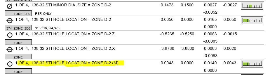

[Ja...] Posted December 5, 2024 Share Posted December 5, 2024 Using the PiWeb Standard Protocol (modified in Calypso), when reportign a True Position with MMC, I get an extra line with a "(M)" at the end. What exactly is this showing? Here is the characteristic: Here is a pic of the report Link to comment https://qualityforum.zeiss.com/topic/21424-calypso-using-piweb-standard-protocol-report-with-additional-report-turned-on/ Share on other sites More sharing options...
[To...] Posted December 5, 2024 Share Posted December 5, 2024 (edited) Please sign in to view this quote. In a nutshell, SPC calculations cannot work with a variable tolerance due to the MMC/LMC. The M value is a percentage of the total tolerance used which can be used in an SPC calculation. There is a workaround to remove this field somewhere in the forum but I don't recall what it is. I think it would be nice to have a simple on or off selection option. Edited December 5, 2024 Link to comment https://qualityforum.zeiss.com/topic/21424-calypso-using-piweb-standard-protocol-report-with-additional-report-turned-on/#findComment-122192 Share on other sites More sharing options...
[Th...] Posted December 5, 2024 Share Posted December 5, 2024 (edited) https://portal.zeiss.com/knowledge-base?id=458620 Here's the KB write-up if you want to hide it from the report. Tom, this is probably the thread you were thinking of (featuring a surprise guest appearance near the end): True Position result with and without MMC on report - General - ZEISS Qualityforum Edited December 5, 2024 Link to comment https://qualityforum.zeiss.com/topic/21424-calypso-using-piweb-standard-protocol-report-with-additional-report-turned-on/#findComment-122216 Share on other sites More sharing options...
