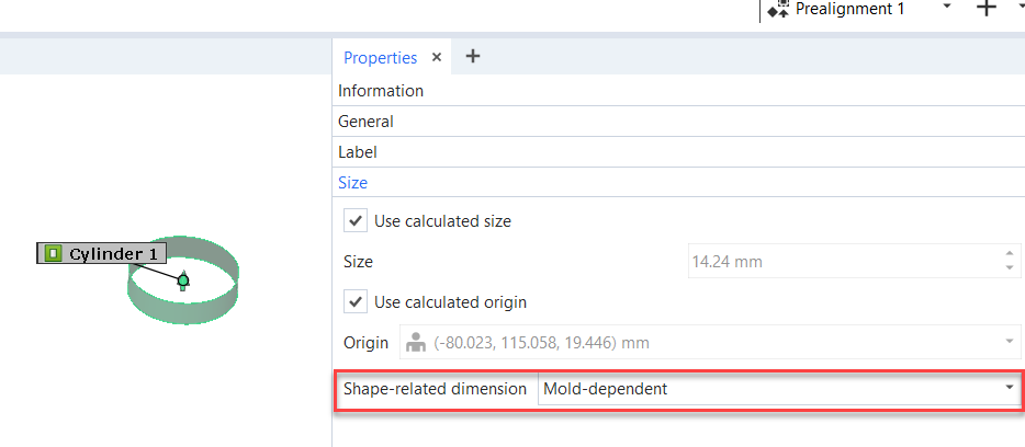

[Jo...] Posted December 5, 2024 Share Posted December 5, 2024 Hi I've made a user defined tolerance table with mold-dependent tolerances as well as mold-independent tolerances. When I set that tolerance table and apply tolerances automatically from it, it always sets values from mold-dependent tolerances. Is there a way to set them accordingly to what they are? I'm using GOM 2019. Thanks, José Oliveira Link to comment Share on other sites More sharing options...
[Ch...] Posted December 6, 2024 Share Posted December 6, 2024 Hello, do you have set your actual element to the correct value, as shown in the following screenshot: Note 1: Screenshot is taken from GOM Software 2021, but in GOM Software it should have a similiar appearance Note 2: Yes we know that a better place (in sense of accessbility) would be the tolerances itself. I hope this solves the problem. Otherwise I would suggest that you contact your local partner to get further support. Best regards Christoph Schult Link to comment Share on other sites More sharing options...
[Jo...] Posted December 6, 2024 Author Share Posted December 6, 2024 Ok, I see it I was looking in the labels properties, not elements. Thank you very much. Link to comment Share on other sites More sharing options...
