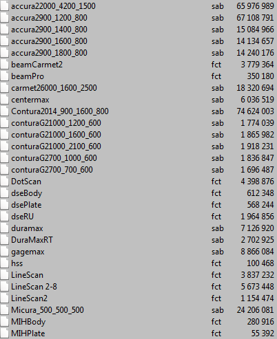

[Ma...] Posted December 9, 2024 Share Posted December 9, 2024 Please sign in to view this quote. It's taken from Calypso 6.6 folder Here it is with size in bytes Link to comment Share on other sites More sharing options...

[Ri...] Posted December 9, 2024 Author Share Posted December 9, 2024 Please sign in to view this quote. That is the same size as the file I have from Zeiss. Link to comment Share on other sites More sharing options...
[No...] Posted December 10, 2024 Share Posted December 10, 2024 Please sign in to view this quote. I took a quick look at that model in my CAD and it looks like many of the machine parts exist twice at the same location. That would explain the size. I don't know if they had a good technical reason to do that or if it was only by accident. Link to comment Share on other sites More sharing options...

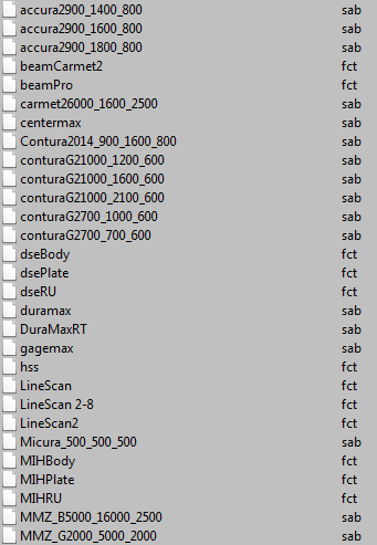

[Hu...] Posted July 14, 2025 Share Posted July 14, 2025 Please sign in to view this quote. could you please share those contura CAD files, I mean the heavy ones? I looked in the Calypso folder but I have the files in the format .vff I am not sure how to convert it into normal step file to open up with other CAD programs. Thanks Link to comment Share on other sites More sharing options...
[Ma...] Posted July 14, 2025 Share Posted July 14, 2025 Please sign in to view this username. I have only found Contura2014_900_1600_800.sab in c:\Program Files (x86)\Zeiss\CALYPSO 6.6\cad-components\ ( 71MB ) Link to comment Share on other sites More sharing options...
